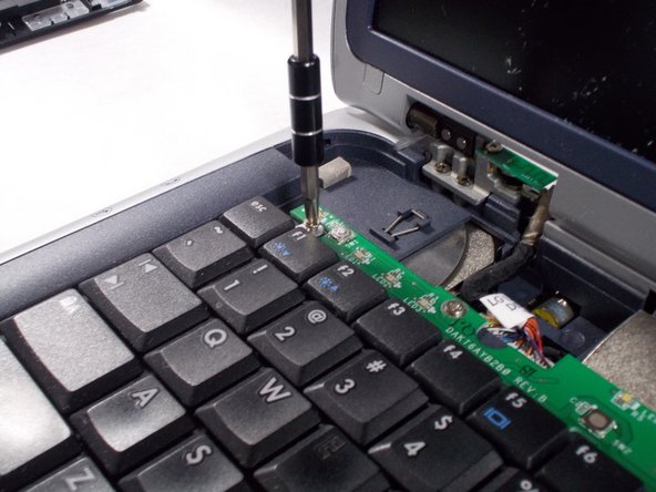

    • Remove the two 5mm Phillips #0 screws from the hinges

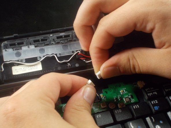

  2. HP Pavilion ze5000 Keyboard Replacement: crwdns2935265:02crwdnd2935265:01crwdnd2935265:02crwdne2935265:0 HP Pavilion ze5000 Keyboard Replacement: crwdns2935265:02crwdnd2935265:02crwdnd2935265:02crwdne2935265:0
    • Open the device as if you were going to use the device. Using Tweezers, pry the hinges from underneath the screen
    • Not much force is needed to pull the hinges off once the tweezers are properly positioned

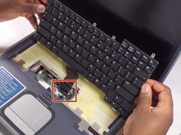

  3. HP Pavilion ze5000 Keyboard Replacement: crwdns2935265:03crwdnd2935265:01crwdnd2935265:02crwdne2935265:0 HP Pavilion ze5000 Keyboard Replacement: crwdns2935265:03crwdnd2935265:02crwdnd2935265:02crwdne2935265:0
    • Remove the wire connection by gently pulling on the fuse and connection itself.
    • Do not pull on the wires, as this can remove the wires from the connection, destroying the fuse.

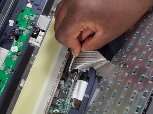

  4. HP Pavilion ze5000 Keyboard Replacement: crwdns2935265:04crwdnd2935265:01crwdnd2935265:03crwdne2935265:0 HP Pavilion ze5000 Keyboard Replacement: crwdns2935265:04crwdnd2935265:02crwdnd2935265:03crwdne2935265:0 HP Pavilion ze5000 Keyboard Replacement: crwdns2935265:04crwdnd2935265:03crwdnd2935265:03crwdne2935265:0
    • Remove the four 4.0 mm Phillips #0 connecting the keyboard to the frame

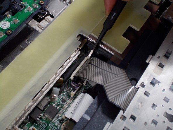

  5. HP Pavilion ze5000 Keyboard Replacement: crwdns2935265:05crwdnd2935265:01crwdnd2935265:02crwdne2935265:0 HP Pavilion ze5000 Keyboard Replacement: crwdns2935265:05crwdnd2935265:02crwdnd2935265:02crwdne2935265:0
    • Gently lift the keyboard up from the frame so that you can see the ribbon still connected.

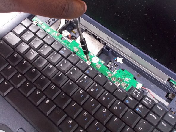

  6. HP Pavilion ze5000 Keyboard Replacement: crwdns2935265:06crwdnd2935265:01crwdnd2935265:03crwdne2935265:0 HP Pavilion ze5000 Keyboard Replacement: crwdns2935265:06crwdnd2935265:02crwdnd2935265:03crwdne2935265:0 HP Pavilion ze5000 Keyboard Replacement: crwdns2935265:06crwdnd2935265:03crwdnd2935265:03crwdne2935265:0
    • Remove the ribbon by gently pulling up the ends of the white receiver it is inserted in to.
    • You may need to use tweezers for this part.
    • During reassembly, when inserting the ribbon, you will hear a quiet, clicking sound when pushing down on the ends of the receiver. Hearing this ensures the ribbon is in place.
To reassemble your device, follow these instructions in reverse order starting at step 5.
