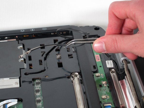

    • Using tweezers, remove the black cable from the hole leading to the WiFi enclosure.
    • Pull gently to remove the black and grey cables from the case.
    • Check the surface beneath the laptop to ensure the cables do not catch on anything when you flip the laptop over.

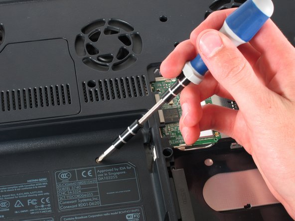

    • Unscrew the four 3mm Philips screws below the vents.

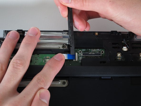

    • Find the ribbon cable on the LED board located at the top of the laptop.
    • You will notice that the ribbon cable is connected to two levels - you will be dealing with the one on the lower level.
    • Find the black latch at the end of the ribbon cable and unlatch it with a spudger to release it.

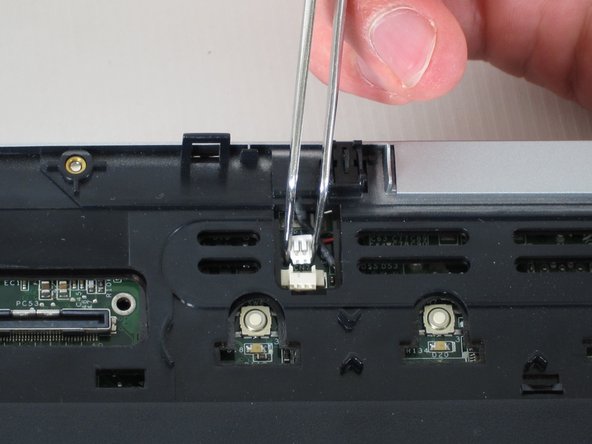

    • Locate the white connector attached to a red and black cable to the right of the LED board.
    • Using tweezers, pull the white connector away from you.
