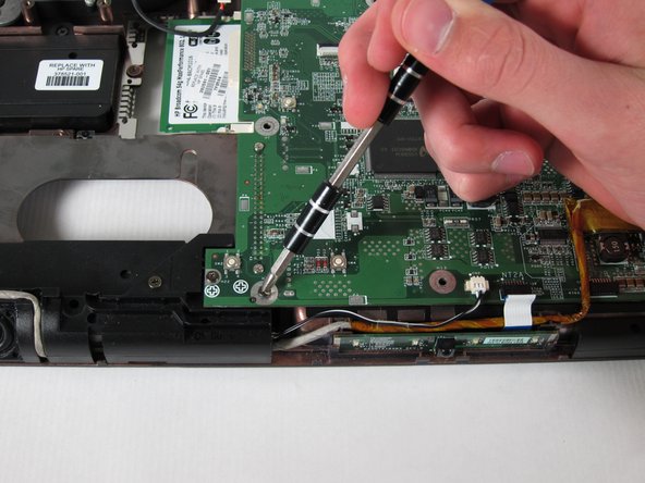

    • Unscrew and remove the five 4mm Philips screws marked with the white Phillips screw icon.

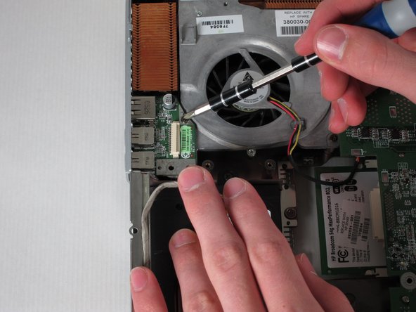

    • Unscrew and remove the two 8mm Philips screws from the heat sink fan.

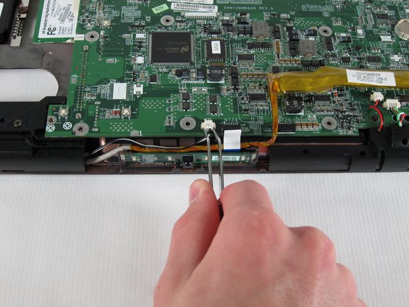

  38. HP Pavilion zd8000 Motherboard Replacement: crwdns2935265:038crwdnd2935265:01crwdnd2935265:02crwdne2935265:0 HP Pavilion zd8000 Motherboard Replacement: crwdns2935265:038crwdnd2935265:02crwdnd2935265:02crwdne2935265:0
    • Using tweezers, remove the left speaker cable by pulling the white connector towards you.
  39. HP Pavilion zd8000 Motherboard Replacement: crwdns2935265:039crwdnd2935265:01crwdnd2935265:02crwdne2935265:0 HP Pavilion zd8000 Motherboard Replacement: crwdns2935265:039crwdnd2935265:02crwdnd2935265:02crwdne2935265:0

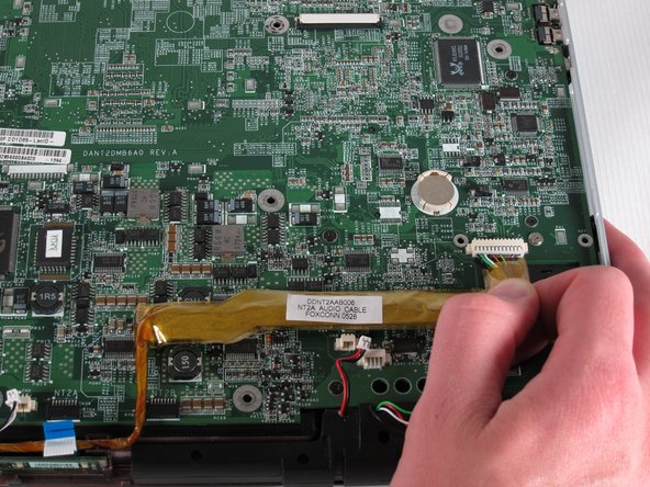

    • Remove the LED board cable by pulling the white tab towards you.
  40. HP Pavilion zd8000 Motherboard Replacement: crwdns2935265:040crwdnd2935265:01crwdnd2935265:02crwdne2935265:0 HP Pavilion zd8000 Motherboard Replacement: crwdns2935265:040crwdnd2935265:02crwdnd2935265:02crwdne2935265:0

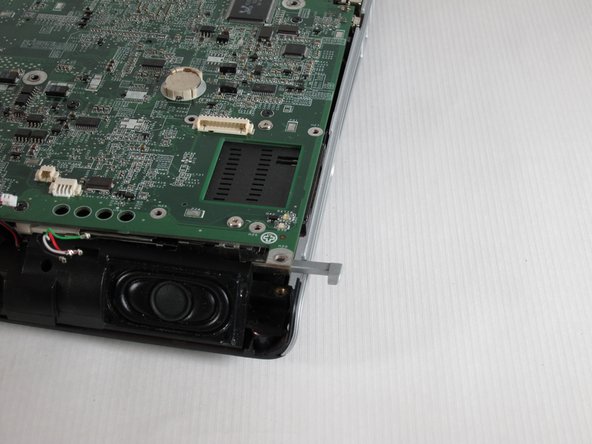

    • Remove the audio cable - the one with the yellow covering located at the bottom-right corner of the motherboard - by pulling the yellow covering towards you.

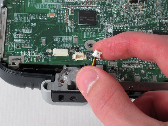

    • Remove the fan cable by pulling the white connector away from you.

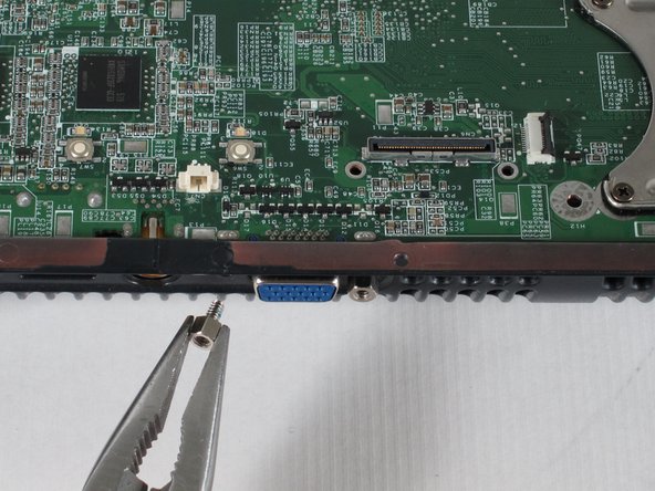

    • Using pliers, unscrew and remove the two bolts from both sides of the blue VGA connector.

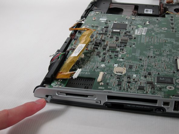

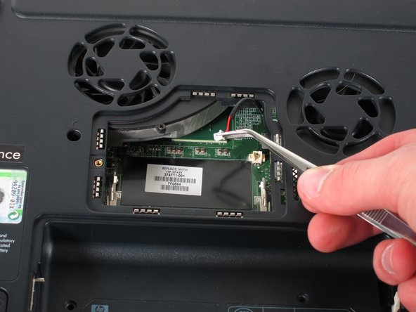

    • Carefully flip the laptop face-down with the battery compartment facing you.
    • Using tweezers, remove the black and red cable from the RAM compartment by pulling on the white connector.

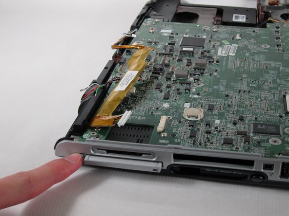

  46. HP Pavilion zd8000 Motherboard Replacement: crwdns2935265:046crwdnd2935265:01crwdnd2935265:02crwdne2935265:0 HP Pavilion zd8000 Motherboard Replacement: crwdns2935265:046crwdnd2935265:02crwdnd2935265:02crwdne2935265:0
    • Flip the laptop face-up and turn it so that the drive labelled "hp usb digital drive" faces you.
    • Press the ridged space saver card above the "hp usb digital drive" label to eject and remove it.
  47. HP Pavilion zd8000 Motherboard Replacement: crwdns2935265:047crwdnd2935265:01crwdnd2935265:03crwdne2935265:0 HP Pavilion zd8000 Motherboard Replacement: crwdns2935265:047crwdnd2935265:02crwdnd2935265:03crwdne2935265:0 HP Pavilion zd8000 Motherboard Replacement: crwdns2935265:047crwdnd2935265:03crwdnd2935265:03crwdne2935265:0
    • Locate the PC card below the SD card reader.
    • Push the button to its left once to eject the button itself, then press it once again to remove the PC card.
  48. HP Pavilion zd8000 Motherboard Replacement: crwdns2935265:048crwdnd2935265:01crwdnd2935265:01crwdne2935265:0
    • Once the PC card pops out, pull it out.

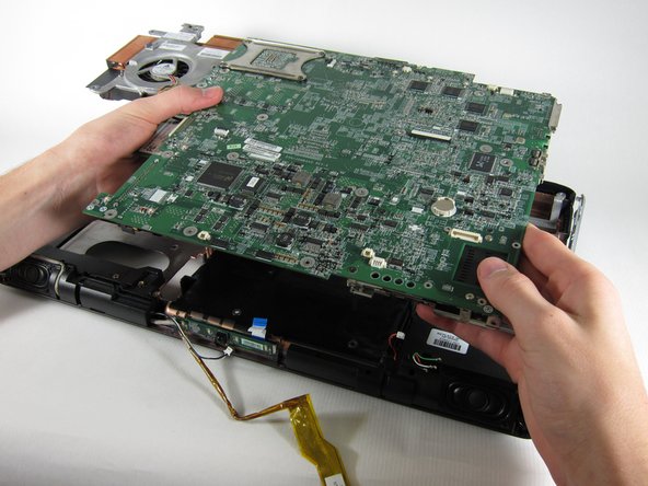

  49. HP Pavilion zd8000 Motherboard Replacement: crwdns2935265:049crwdnd2935265:01crwdnd2935265:02crwdne2935265:0 HP Pavilion zd8000 Motherboard Replacement: crwdns2935265:049crwdnd2935265:02crwdnd2935265:02crwdne2935265:0
    • Turn the computer 90 degrees counter-clockwise and clear all cables off of the motherboard.
    • Push in the grey button to the left of the PC card as far as possible.
    • Keeping the button pressed down, lift the motherboard up until the button pops out the top of the case.
  50. HP Pavilion zd8000 Motherboard Replacement: crwdns2935265:050crwdnd2935265:01crwdnd2935265:01crwdne2935265:0
    • Pull the right casing to the side to release the ports on the motherboard from it.
  51. HP Pavilion zd8000 Motherboard Replacement: crwdns2935265:051crwdnd2935265:01crwdnd2935265:02crwdne2935265:0 HP Pavilion zd8000 Motherboard Replacement: crwdns2935265:051crwdnd2935265:02crwdnd2935265:02crwdne2935265:0
    • Lift the motherboard up until it releases from the bottom casing and remove it from the laptop.
