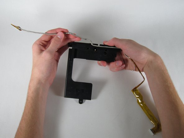

  35. HP Pavilion zd8000 Left Speaker Replacement, Motherboard: crwdns2935265:035crwdnd2935265:01crwdnd2935265:02crwdne2935265:0 HP Pavilion zd8000 Left Speaker Replacement, Motherboard: crwdns2935265:035crwdnd2935265:02crwdnd2935265:02crwdne2935265:0
    • Unscrew and remove the five 4mm Philips screws marked with the white Phillips screw icon.
  36. HP Pavilion zd8000 Left Speaker Replacement: crwdns2935265:036crwdnd2935265:01crwdnd2935265:01crwdne2935265:0
    • Unscrew and remove the two 8mm Philips screws from the heat sink fan.
  37. HP Pavilion zd8000 Left Speaker Replacement: crwdns2935265:037crwdnd2935265:01crwdnd2935265:01crwdne2935265:0
    • Using tweezers, remove the digital drive board cable - the cable set on the right with black, red, green, and white wires.
    • Using tweezers, remove the the rigth speaker cable - the cable set on the left with red and black wires - by pulling the white connector towards you.
  38. HP Pavilion zd8000 Left Speaker Replacement: crwdns2935265:038crwdnd2935265:01crwdnd2935265:02crwdne2935265:0 HP Pavilion zd8000 Left Speaker Replacement: crwdns2935265:038crwdnd2935265:02crwdnd2935265:02crwdne2935265:0
    • Using tweezers, remove the left speaker cable by pulling the white connector towards you.
  39. HP Pavilion zd8000 Left Speaker Replacement: crwdns2935265:039crwdnd2935265:01crwdnd2935265:02crwdne2935265:0 HP Pavilion zd8000 Left Speaker Replacement: crwdns2935265:039crwdnd2935265:02crwdnd2935265:02crwdne2935265:0
    • Remove the LED board cable by pulling the white tab towards you.
  40. HP Pavilion zd8000 Left Speaker Replacement: crwdns2935265:040crwdnd2935265:01crwdnd2935265:02crwdne2935265:0 HP Pavilion zd8000 Left Speaker Replacement: crwdns2935265:040crwdnd2935265:02crwdnd2935265:02crwdne2935265:0
    • Remove the audio cable - the one with the yellow covering located at the bottom-right corner of the motherboard - by pulling the yellow covering towards you.
  41. HP Pavilion zd8000 Left Speaker Replacement: crwdns2935265:041crwdnd2935265:01crwdnd2935265:03crwdne2935265:0 HP Pavilion zd8000 Left Speaker Replacement: crwdns2935265:041crwdnd2935265:02crwdnd2935265:03crwdne2935265:0 HP Pavilion zd8000 Left Speaker Replacement: crwdns2935265:041crwdnd2935265:03crwdnd2935265:03crwdne2935265:0
    • Rotate the laptop 180 degrees and locate the Bluetooth module at the bottom-left corner of the motherboard.
    • Using tweezers, remove the Bluetooth module’s white connector by pulling it away from you.
  42. HP Pavilion zd8000 Left Speaker Replacement: crwdns2935265:042crwdnd2935265:01crwdnd2935265:02crwdne2935265:0 HP Pavilion zd8000 Left Speaker Replacement: crwdns2935265:042crwdnd2935265:02crwdnd2935265:02crwdne2935265:0
    • Using tweezers, pull up on the Bluetooth module to remove it.
  43. HP Pavilion zd8000 Left Speaker Replacement: crwdns2935265:043crwdnd2935265:01crwdnd2935265:02crwdne2935265:0 HP Pavilion zd8000 Left Speaker Replacement: crwdns2935265:043crwdnd2935265:02crwdnd2935265:02crwdne2935265:0
    • Remove the fan cable by pulling the white connector away from you.
  44. HP Pavilion zd8000 Left Speaker Replacement: crwdns2935265:044crwdnd2935265:01crwdnd2935265:02crwdne2935265:0 HP Pavilion zd8000 Left Speaker Replacement: crwdns2935265:044crwdnd2935265:02crwdnd2935265:02crwdne2935265:0
    • Using pliers, unscrew and remove the two bolts from both sides of the blue VGA connector.
  45. HP Pavilion zd8000 Left Speaker Replacement: crwdns2935265:045crwdnd2935265:01crwdnd2935265:02crwdne2935265:0 HP Pavilion zd8000 Left Speaker Replacement: crwdns2935265:045crwdnd2935265:02crwdnd2935265:02crwdne2935265:0
    • Carefully flip the laptop face-down with the battery compartment facing you.
    • Using tweezers, remove the black and red cable from the RAM compartment by pulling on the white connector.
  46. HP Pavilion zd8000 Left Speaker Replacement: crwdns2935265:046crwdnd2935265:01crwdnd2935265:02crwdne2935265:0 HP Pavilion zd8000 Left Speaker Replacement: crwdns2935265:046crwdnd2935265:02crwdnd2935265:02crwdne2935265:0
    • Flip the laptop face-up and turn it so that the drive labelled "hp usb digital drive" faces you.
    • Press the ridged space saver card above the "hp usb digital drive" label to eject and remove it.
  47. HP Pavilion zd8000 Left Speaker Replacement: crwdns2935265:047crwdnd2935265:01crwdnd2935265:03crwdne2935265:0 HP Pavilion zd8000 Left Speaker Replacement: crwdns2935265:047crwdnd2935265:02crwdnd2935265:03crwdne2935265:0 HP Pavilion zd8000 Left Speaker Replacement: crwdns2935265:047crwdnd2935265:03crwdnd2935265:03crwdne2935265:0
    • Locate the PC card below the SD card reader.
    • Push the button to its left once to eject the button itself, then press it once again to remove the PC card.
  48. HP Pavilion zd8000 Left Speaker Replacement: crwdns2935265:048crwdnd2935265:01crwdnd2935265:01crwdne2935265:0
    • Once the PC card pops out, pull it out.
  49. HP Pavilion zd8000 Left Speaker Replacement: crwdns2935265:049crwdnd2935265:01crwdnd2935265:02crwdne2935265:0 HP Pavilion zd8000 Left Speaker Replacement: crwdns2935265:049crwdnd2935265:02crwdnd2935265:02crwdne2935265:0
    • Turn the computer 90 degrees counter-clockwise and clear all cables off of the motherboard.
    • Push in the grey button to the left of the PC card as far as possible.

  54. HP Pavilion zd8000 Left Speaker Replacement: crwdns2935265:054crwdnd2935265:01crwdnd2935265:02crwdne2935265:0 HP Pavilion zd8000 Left Speaker Replacement: crwdns2935265:054crwdnd2935265:02crwdnd2935265:02crwdne2935265:0
    • Lift the speaker unit up, flip it, and remove the USB cable.
  55. HP Pavilion zd8000 Left Speaker Replacement: crwdns2935265:055crwdnd2935265:01crwdnd2935265:01crwdne2935265:0
    • Cut the tape that attaches the USB cable to the left speaker cable.
