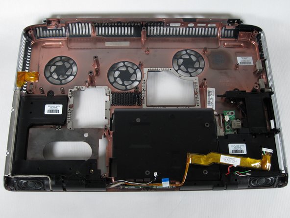

  35. HP Pavilion zd8000 Base Fans Replacement, Motherboard: crwdns2935265:035crwdnd2935265:01crwdnd2935265:02crwdne2935265:0 HP Pavilion zd8000 Base Fans Replacement, Motherboard: crwdns2935265:035crwdnd2935265:02crwdnd2935265:02crwdne2935265:0
    • Unscrew and remove the five 4mm Philips screws marked with the white Phillips screw icon.

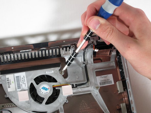

  36. HP Pavilion zd8000 Base Fans Replacement: crwdns2935265:036crwdnd2935265:01crwdnd2935265:01crwdne2935265:0
    • Unscrew and remove the two 8mm Philips screws from the heat sink fan.
  37. HP Pavilion zd8000 Base Fans Replacement: crwdns2935265:037crwdnd2935265:01crwdnd2935265:01crwdne2935265:0
    • Using tweezers, remove the digital drive board cable - the cable set on the right with black, red, green, and white wires.
    • Using tweezers, remove the the rigth speaker cable - the cable set on the left with red and black wires - by pulling the white connector towards you.
  38. HP Pavilion zd8000 Base Fans Replacement: crwdns2935265:038crwdnd2935265:01crwdnd2935265:02crwdne2935265:0 HP Pavilion zd8000 Base Fans Replacement: crwdns2935265:038crwdnd2935265:02crwdnd2935265:02crwdne2935265:0
    • Using tweezers, remove the left speaker cable by pulling the white connector towards you.
  39. HP Pavilion zd8000 Base Fans Replacement: crwdns2935265:039crwdnd2935265:01crwdnd2935265:02crwdne2935265:0 HP Pavilion zd8000 Base Fans Replacement: crwdns2935265:039crwdnd2935265:02crwdnd2935265:02crwdne2935265:0
    • Remove the LED board cable by pulling the white tab towards you.
  40. HP Pavilion zd8000 Base Fans Replacement: crwdns2935265:040crwdnd2935265:01crwdnd2935265:02crwdne2935265:0 HP Pavilion zd8000 Base Fans Replacement: crwdns2935265:040crwdnd2935265:02crwdnd2935265:02crwdne2935265:0
    • Remove the audio cable - the one with the yellow covering located at the bottom-right corner of the motherboard - by pulling the yellow covering towards you.

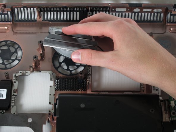

  43. HP Pavilion zd8000 Base Fans Replacement: crwdns2935265:043crwdnd2935265:01crwdnd2935265:02crwdne2935265:0 HP Pavilion zd8000 Base Fans Replacement: crwdns2935265:043crwdnd2935265:02crwdnd2935265:02crwdne2935265:0
    • Remove the fan cable by pulling the white connector away from you.

  52. HP Pavilion zd8000 Base Fans Replacement, Base Fans: crwdns2935265:052crwdnd2935265:01crwdnd2935265:02crwdne2935265:0 HP Pavilion zd8000 Base Fans Replacement, Base Fans: crwdns2935265:052crwdnd2935265:02crwdnd2935265:02crwdne2935265:0
    • Unscrew the two 8mm Philips screws on both sides of the middle fan and remove them.
    • Unscrew the four 8mm Phillips screws from the right fan and remove them.
  53. HP Pavilion zd8000 Base Fans Replacement: crwdns2935265:053crwdnd2935265:01crwdnd2935265:03crwdne2935265:0 HP Pavilion zd8000 Base Fans Replacement: crwdns2935265:053crwdnd2935265:02crwdnd2935265:03crwdne2935265:0 HP Pavilion zd8000 Base Fans Replacement: crwdns2935265:053crwdnd2935265:03crwdnd2935265:03crwdne2935265:0
    • Lift both fans up and remove them from the laptop casing.
