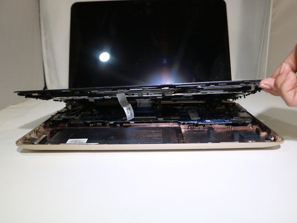

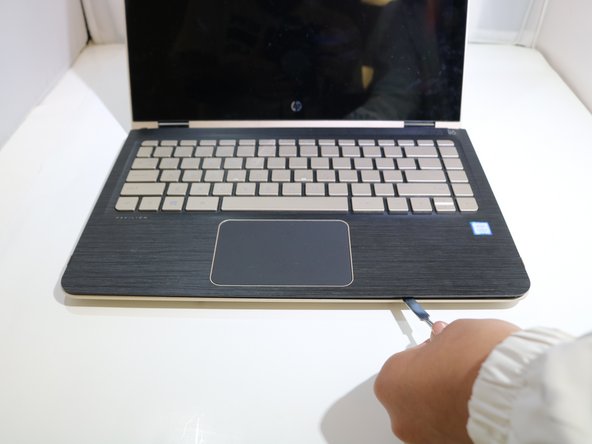

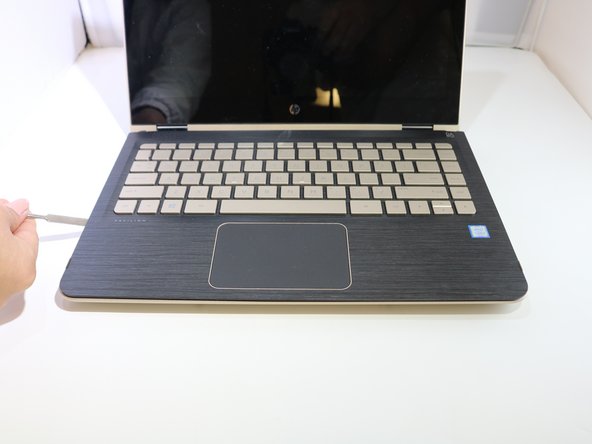

  4. HP Pavilion x360 m3-u103dx HP Pavilion x360 m3-u103dx Keyboard Replacement: crwdns2935265:04crwdnd2935265:01crwdnd2935265:03crwdne2935265:0 HP Pavilion x360 m3-u103dx HP Pavilion x360 m3-u103dx Keyboard Replacement: crwdns2935265:04crwdnd2935265:02crwdnd2935265:03crwdne2935265:0 HP Pavilion x360 m3-u103dx HP Pavilion x360 m3-u103dx Keyboard Replacement: crwdns2935265:04crwdnd2935265:03crwdnd2935265:03crwdne2935265:0
    • Flip the laptop over to screen and keyboard side.
    • Using a Metal Spudger pop open keyboard from base of laptop.
    • Be cautious of three wires on the inside of the keyboard connecting it to the motherboard.

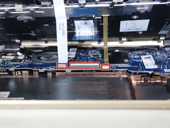

  5. HP Pavilion x360 m3-u103dx HP Pavilion x360 m3-u103dx Keyboard Replacement: crwdns2935265:05crwdnd2935265:01crwdnd2935265:02crwdne2935265:0 HP Pavilion x360 m3-u103dx HP Pavilion x360 m3-u103dx Keyboard Replacement: crwdns2935265:05crwdnd2935265:02crwdnd2935265:02crwdne2935265:0
    • Disconnect the three connected cable ribbons connected to the motherboard by gently pulling them out of their connectors.
  6. HP Pavilion x360 m3-u103dx HP Pavilion x360 m3-u103dx Keyboard Replacement: crwdns2935265:06crwdnd2935265:01crwdnd2935265:02crwdne2935265:0 HP Pavilion x360 m3-u103dx HP Pavilion x360 m3-u103dx Keyboard Replacement: crwdns2935265:06crwdnd2935265:02crwdnd2935265:02crwdne2935265:0
    • After ribbon cables have been disconnected, carefully lift up keyboard to disconnect from base of laptop.
