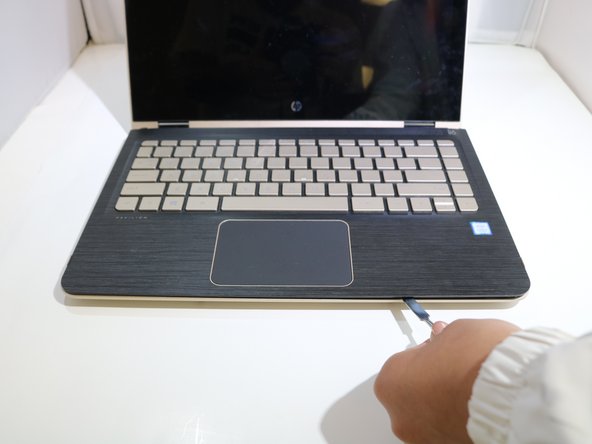

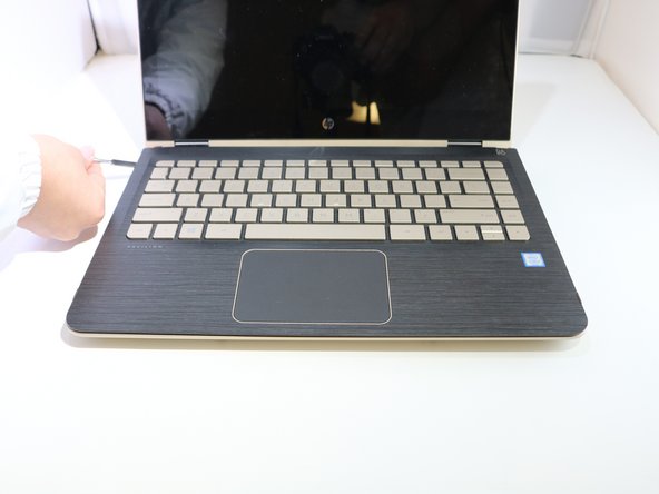

    • Open computer and pry open keyboard panel using the Metal Spudger. Apply little pressure then increase until keyboard pops away from motherboard.
    • Be careful not to pull or disconnect ribbon cables first.

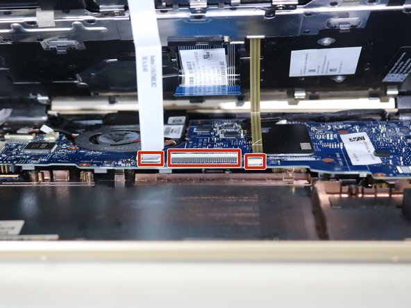

  5. HP Pavilion x360 m3-u103dx Battery Replacement: crwdns2935265:05crwdnd2935265:01crwdnd2935265:02crwdne2935265:0 HP Pavilion x360 m3-u103dx Battery Replacement: crwdns2935265:05crwdnd2935265:02crwdnd2935265:02crwdne2935265:0
    • Gently lift the keyboard on the mouse pad side, but do not remove.
    • The keyboard is still connected by three ribbon cables.
    • Remove three connected ribbon wires connecting keyboard to frame by gently disconnecting them from the motherboard.

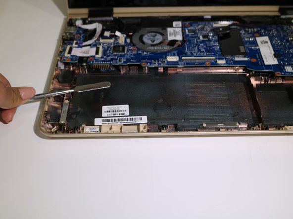

  6. HP Pavilion x360 m3-u103dx Battery Replacement: crwdns2935265:06crwdnd2935265:01crwdnd2935265:01crwdne2935265:0
    • Use a Phillips #00 screwdriver to remove six screws around the battery.
    • 6 Phillips 2.0 x 4.6 mm screws.
  7. HP Pavilion x360 m3-u103dx Battery Replacement: crwdns2935265:07crwdnd2935265:01crwdnd2935265:02crwdne2935265:0 HP Pavilion x360 m3-u103dx Battery Replacement: crwdns2935265:07crwdnd2935265:02crwdnd2935265:02crwdne2935265:0
    • Gently lift the battery up and away from the casing.
    • Carefully remove the battery from its connecting port.
