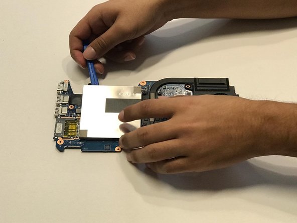

    • Use an iFixit opening tool to snap the silver the case off of the motherboard.

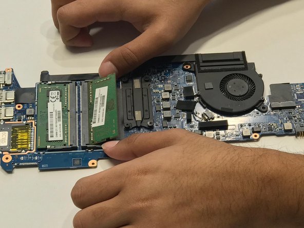

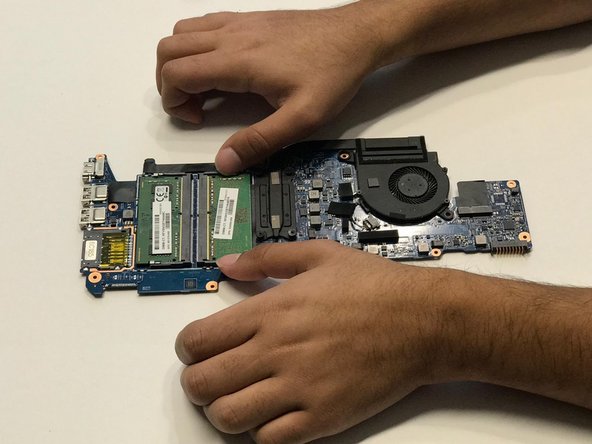

  10. HP Pavilion x360 m3-u101dx RAM Replacement: crwdns2935265:010crwdnd2935265:01crwdnd2935265:03crwdne2935265:0 HP Pavilion x360 m3-u101dx RAM Replacement: crwdns2935265:010crwdnd2935265:02crwdnd2935265:03crwdne2935265:0 HP Pavilion x360 m3-u101dx RAM Replacement: crwdns2935265:010crwdnd2935265:03crwdnd2935265:03crwdne2935265:0
    • Push down on the metal locks on each side of the RAM to pop the sticks out.
    • Make sure to move the metal locks aside before you push the RAM back in place.
