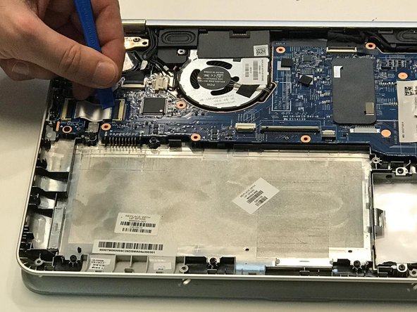

  6. HP Pavilion x360 m3-u101dx Processor Replacement, Motherboard: crwdns2935265:06crwdnd2935265:01crwdnd2935265:03crwdne2935265:0 HP Pavilion x360 m3-u101dx Processor Replacement, Motherboard: crwdns2935265:06crwdnd2935265:02crwdnd2935265:03crwdne2935265:0 HP Pavilion x360 m3-u101dx Processor Replacement, Motherboard: crwdns2935265:06crwdnd2935265:03crwdnd2935265:03crwdne2935265:0
    • The component that you MUST disconnect first is the battery to prevent any power that might be stored in the the computer even if it is shutdown.
    • Use a plastic opening tool to lift the battery cable out from the motherboard.
    • Disconnect the seven ribbon cables connected to the motherboard using a finger or plastic opening tool.
    • You can work from left to right from the battery to ensure no cables are missed.

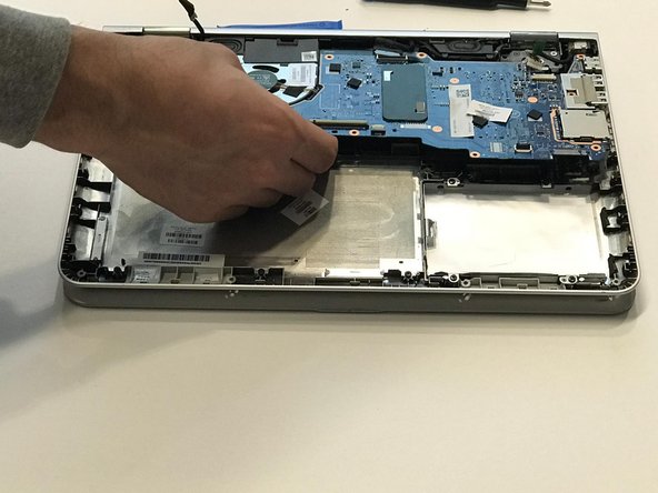

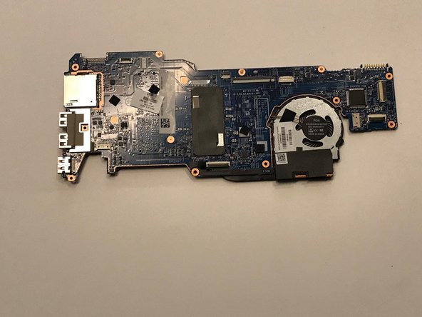

  8. HP Pavilion x360 m3-u101dx Processor Replacement: crwdns2935265:08crwdnd2935265:01crwdnd2935265:03crwdne2935265:0 HP Pavilion x360 m3-u101dx Processor Replacement: crwdns2935265:08crwdnd2935265:02crwdnd2935265:03crwdne2935265:0 HP Pavilion x360 m3-u101dx Processor Replacement: crwdns2935265:08crwdnd2935265:03crwdnd2935265:03crwdne2935265:0
    • Remove the motherboard by lifting it up and pulling it out.
    • DO NOT force it out if the motherboard appears to be stuck. Track back and see what is preventing the motherboard from being removed (i.e. cable or screw) to prevent any damage to other components.

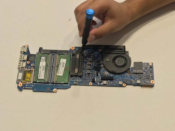

  9. HP Pavilion x360 m3-u101dx Processor Replacement, Processor: crwdns2935265:09crwdnd2935265:01crwdnd2935265:03crwdne2935265:0 HP Pavilion x360 m3-u101dx Processor Replacement, Processor: crwdns2935265:09crwdnd2935265:02crwdnd2935265:03crwdne2935265:0 HP Pavilion x360 m3-u101dx Processor Replacement, Processor: crwdns2935265:09crwdnd2935265:03crwdnd2935265:03crwdne2935265:0
    • Use the Phillips #1 screwdriver to remove the screws from the fan.

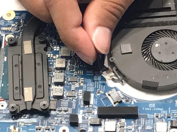

  10. HP Pavilion x360 m3-u101dx Processor Replacement: crwdns2935265:010crwdnd2935265:01crwdnd2935265:02crwdne2935265:0 HP Pavilion x360 m3-u101dx Processor Replacement: crwdns2935265:010crwdnd2935265:02crwdnd2935265:02crwdne2935265:0
    • Gently detach the fan cable with your hands.

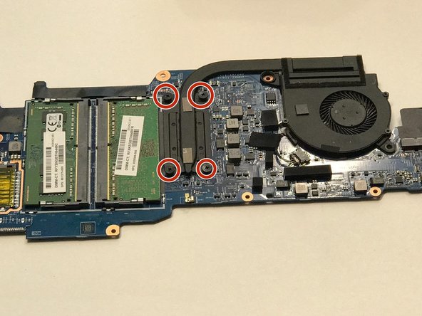

  11. HP Pavilion x360 m3-u101dx Processor Replacement: crwdns2935265:011crwdnd2935265:01crwdnd2935265:01crwdne2935265:0
    • Remove a hidden screw on the CPU and remove the CPU from the motherboard.
    • When replacing the CPU, make sure to align the notch pins correctly, and put the screw back in place.
    • Add thermal paste on top of the middle of your new CPU.
