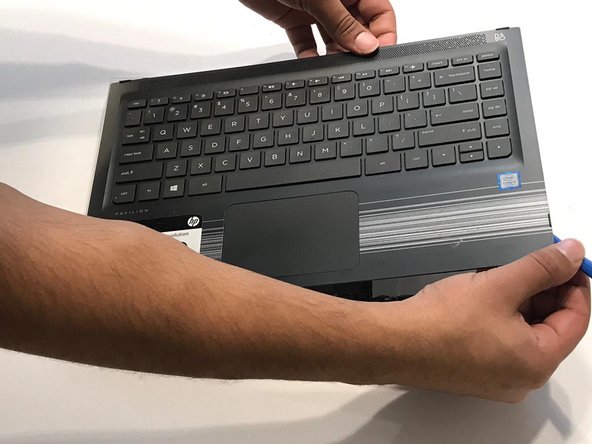

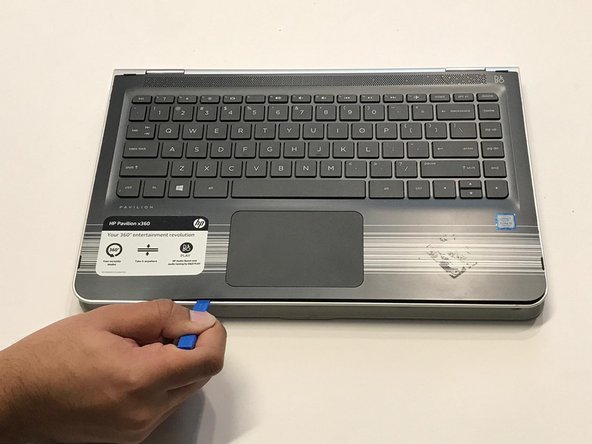

  4. HP Pavilion x360 m3-u101dx Keyboard Panel Replacement: crwdns2935265:04crwdnd2935265:01crwdnd2935265:03crwdne2935265:0 HP Pavilion x360 m3-u101dx Keyboard Panel Replacement: crwdns2935265:04crwdnd2935265:02crwdnd2935265:03crwdne2935265:0 HP Pavilion x360 m3-u101dx Keyboard Panel Replacement: crwdns2935265:04crwdnd2935265:03crwdnd2935265:03crwdne2935265:0
    • Lift open the laptop screen and flip it around so that the keyboard is facing up.
    • Insert a plastic opening tool into one of the corners to create a gap between the bottom panel and the keyboard panel.
    • Guide the plastic opening tool around the perimeter of the panel to detach all the clips that are supporting it in place.
    • Do not pull the panel off by one corner as it can cause damage to the plastic.
    • Detach the keyboard panel from the frame.
    • There are two ribbon cables attached to the keyboard and trackpad so do not pull the keyboard panel away until you disconnect these ribbons in the next step.

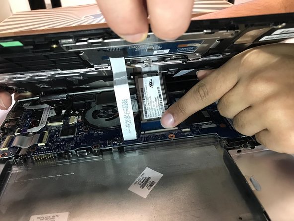

  5. HP Pavilion x360 m3-u101dx Keyboard Panel Replacement: crwdns2935265:05crwdnd2935265:01crwdnd2935265:03crwdne2935265:0 HP Pavilion x360 m3-u101dx Keyboard Panel Replacement: crwdns2935265:05crwdnd2935265:02crwdnd2935265:03crwdne2935265:0 HP Pavilion x360 m3-u101dx Keyboard Panel Replacement: crwdns2935265:05crwdnd2935265:03crwdnd2935265:03crwdne2935265:0
    • Remove the two ribbon cables connected to the inside of the laptop by using a finger to lift up on the latches.
    • Remove the keyboard panel from the rest of the laptop.
