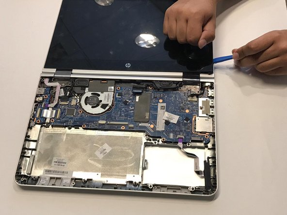

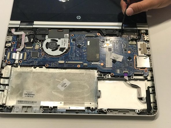

  6. HP Pavilion x360 m3-u101dx Display Replacement, Display: crwdns2935265:06crwdnd2935265:01crwdnd2935265:03crwdne2935265:0 HP Pavilion x360 m3-u101dx Display Replacement, Display: crwdns2935265:06crwdnd2935265:02crwdnd2935265:03crwdne2935265:0 HP Pavilion x360 m3-u101dx Display Replacement, Display: crwdns2935265:06crwdnd2935265:03crwdnd2935265:03crwdne2935265:0
    • Use the iFixit opening tool to flip the cable tab up, located at the top right corner of the motherboard.
    • Detach the display power cable from the motherboard.
    • Once the cable is loose, remove it from the cable case.

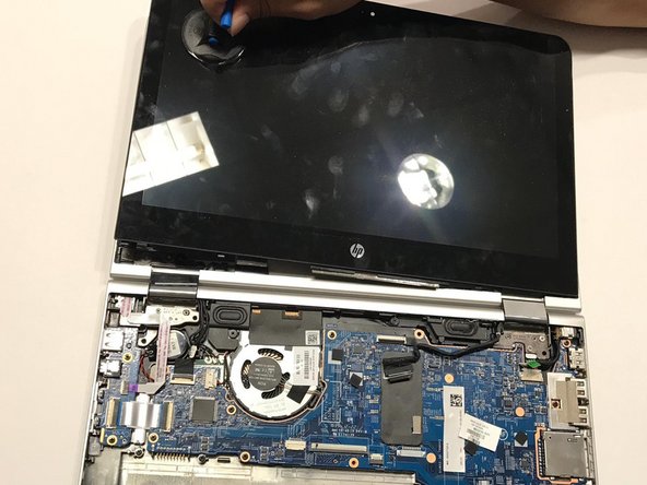

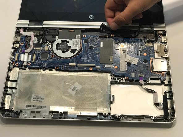

  7. HP Pavilion x360 m3-u101dx Display Replacement: crwdns2935265:07crwdnd2935265:01crwdnd2935265:03crwdne2935265:0 HP Pavilion x360 m3-u101dx Display Replacement: crwdns2935265:07crwdnd2935265:02crwdnd2935265:03crwdne2935265:0 HP Pavilion x360 m3-u101dx Display Replacement: crwdns2935265:07crwdnd2935265:03crwdnd2935265:03crwdne2935265:0
    • Use the suction handle and attach it to the bottom corner of the display.
    • Slide the iFixit opening tool around the display to loosen the clips attaching it to the case.
    • If you have difficulty removing the display, move the suction handle to the other corners.
    • When the display is removed from the case, pull the power cable from the bottom case through the hinge.
