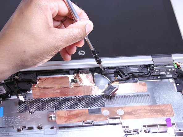

  19. HP Pavilion x360 m3-u001dx Speakers Replacement, Speakers: crwdns2935265:019crwdnd2935265:01crwdnd2935265:01crwdne2935265:0
    • Remove the cable from its routing path.
  20. HP Pavilion x360 m3-u001dx Speakers Replacement: crwdns2935265:020crwdnd2935265:01crwdnd2935265:02crwdne2935265:0 HP Pavilion x360 m3-u001dx Speakers Replacement: crwdns2935265:020crwdnd2935265:02crwdnd2935265:02crwdne2935265:0
    • Remove the 2 Phillips 3.0 x 5.6 mm screws.
  21. HP Pavilion x360 m3-u001dx Speakers Replacement: crwdns2935265:021crwdnd2935265:01crwdnd2935265:01crwdne2935265:0
    • Carefully peel back the foil as necessary to free the speaker cable from the base of the laptop.
  22. HP Pavilion x360 m3-u001dx Speakers Replacement: crwdns2935265:022crwdnd2935265:01crwdnd2935265:01crwdne2935265:0
    • Lift the speakers away from the base of the laptop.
Follow these instructions in reverse order to reassemble your device.
