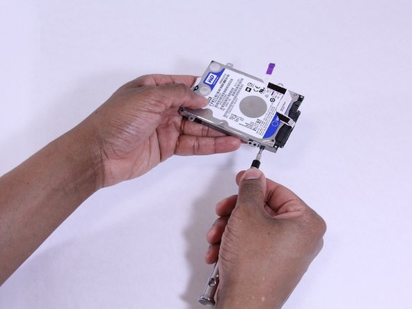

  13. HP Pavilion x360 m3-u001dx Hard Drive Replacement: crwdns2935265:013crwdnd2935265:01crwdnd2935265:01crwdne2935265:0
    • Using the tab provided, lift and remove the hard drive out of the laptop base.
  14. HP Pavilion x360 m3-u001dx Hard Drive Replacement: crwdns2935265:014crwdnd2935265:01crwdnd2935265:02crwdne2935265:0 HP Pavilion x360 m3-u001dx Hard Drive Replacement: crwdns2935265:014crwdnd2935265:02crwdnd2935265:02crwdne2935265:0
    • Using the Phillips00 Screw Driver, remove 4 Phillips 3.0 x 3.7 mm screws on exterior mounting bracket.
    • There are 2 Phillips screws on each side of the hard drive bracket.
    • Make special note of each screw and screw lock size and location during removal and replacement.
  15. HP Pavilion x360 m3-u001dx Hard Drive Replacement: crwdns2935265:015crwdnd2935265:01crwdnd2935265:01crwdne2935265:0
    • Remove the mounting bracket.
Follow these instructions in reverse order to reassemble your device.
