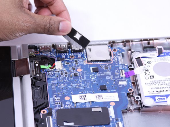

  11. HP Pavilion x360 m3-u001dx Display Replacement, USB Port Shield: crwdns2935265:011crwdnd2935265:01crwdnd2935265:03crwdne2935265:0 HP Pavilion x360 m3-u001dx Display Replacement, USB Port Shield: crwdns2935265:011crwdnd2935265:02crwdnd2935265:03crwdne2935265:0 HP Pavilion x360 m3-u001dx Display Replacement, USB Port Shield: crwdns2935265:011crwdnd2935265:03crwdnd2935265:03crwdne2935265:0
    • (You don't NEED to remove this shielding as you can remove the board with it still there.)
    • Remove the adhesive strip.
    • Lift the shield away from the base of the laptop.

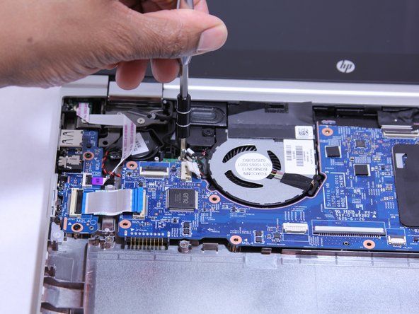

  12. HP Pavilion x360 m3-u001dx Display Replacement, System Board (Motherboard): crwdns2935265:012crwdnd2935265:01crwdnd2935265:03crwdne2935265:0 HP Pavilion x360 m3-u001dx Display Replacement, System Board (Motherboard): crwdns2935265:012crwdnd2935265:02crwdnd2935265:03crwdne2935265:0 HP Pavilion x360 m3-u001dx Display Replacement, System Board (Motherboard): crwdns2935265:012crwdnd2935265:03crwdnd2935265:03crwdne2935265:0

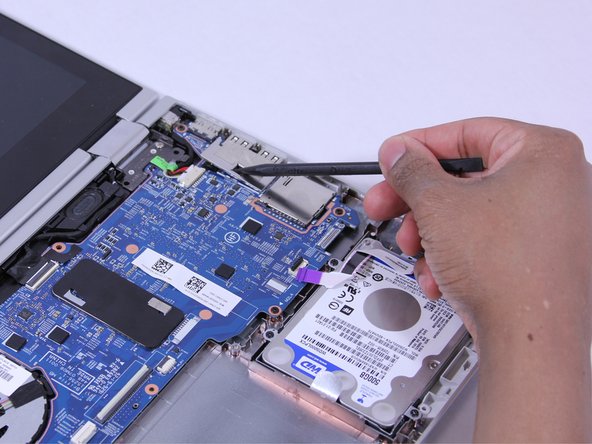

    Heavy-Duty Spudger
    • Disconnect the ribbon cables attached to the system board (motherboard).
    • Using the Heavy-Duty Spudger lift up the plastic locks connecting the ribbon cable to the motherboard.
    • Use the plastic tab on the ribbon cable to pull it out from the lock on the motherboard.

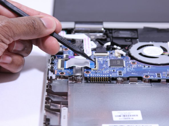

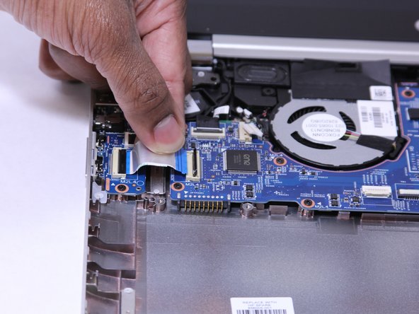

  13. HP Pavilion x360 m3-u001dx Display Replacement: crwdns2935265:013crwdnd2935265:01crwdnd2935265:02crwdne2935265:0 HP Pavilion x360 m3-u001dx Display Replacement: crwdns2935265:013crwdnd2935265:02crwdnd2935265:02crwdne2935265:0
    • Disconnect the fastened cables from the system board (motherboard) by carefully pushing the cable's plastic edges using the Heavy Duty Spudger.

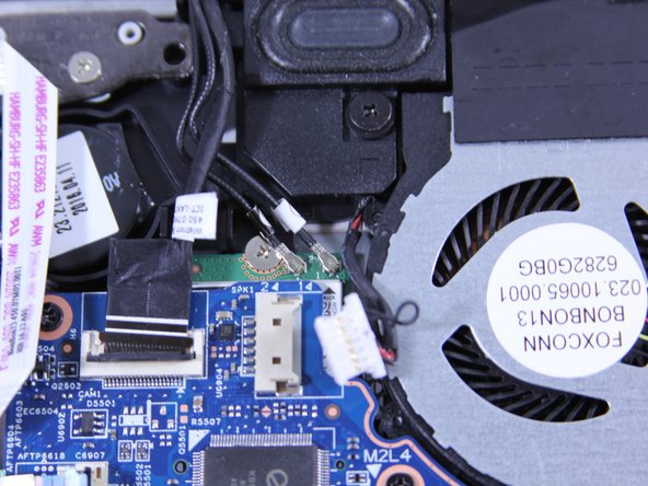

  14. HP Pavilion x360 m3-u001dx Display Replacement: crwdns2935265:014crwdnd2935265:01crwdnd2935265:02crwdne2935265:0 HP Pavilion x360 m3-u001dx Display Replacement: crwdns2935265:014crwdnd2935265:02crwdnd2935265:02crwdne2935265:0
    • Pull the clipped cables from system board (motherboard).

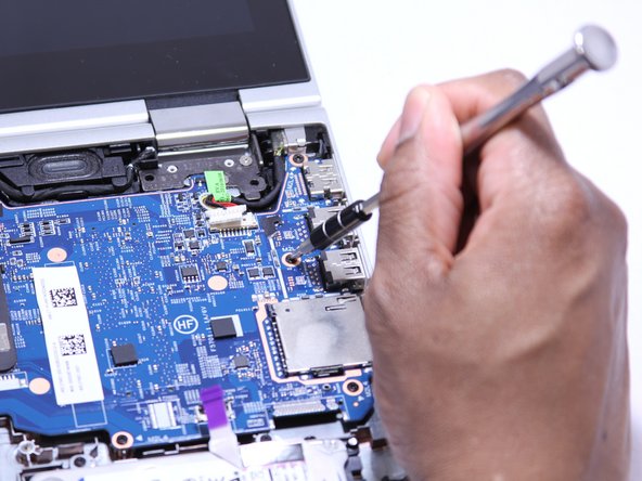

  15. HP Pavilion x360 m3-u001dx Display Replacement: crwdns2935265:015crwdnd2935265:01crwdnd2935265:03crwdne2935265:0 HP Pavilion x360 m3-u001dx Display Replacement: crwdns2935265:015crwdnd2935265:02crwdnd2935265:03crwdne2935265:0 HP Pavilion x360 m3-u001dx Display Replacement: crwdns2935265:015crwdnd2935265:03crwdnd2935265:03crwdne2935265:0
    • Remove the system board (motherboard).
    • Using the Phillips 00 Screw Driver, remove 9 Phillips 2.0 x 4.7 mm screws with "M2L4" next to them.
    • Using the Phillips 00 Screw Driver, remove the silver screw.
    • Make special note of each screw and screw lock size and location during removal and replacement.

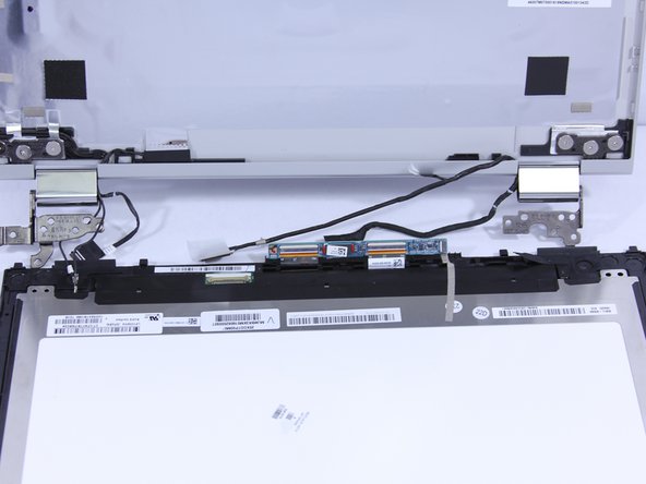

  21. HP Pavilion x360 m3-u001dx Display Replacement: crwdns2935265:021crwdnd2935265:01crwdnd2935265:01crwdne2935265:0
    • Use a Metal Spudger to pry the display panel from the outer casing.
    • Start from the top of the display panel and move along the edges and do not to push the metal spudger too far into the screen.
    • Be cautious not to apply heavy pressure to the display panel. This could damage the touch screen.

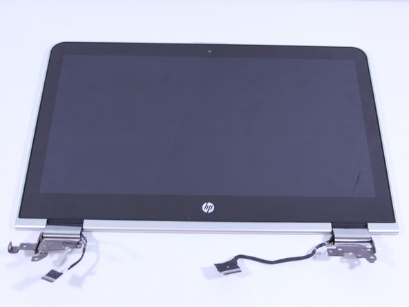

  22. HP Pavilion x360 m3-u001dx Display Replacement: crwdns2935265:022crwdnd2935265:01crwdnd2935265:01crwdne2935265:0
    • Open the display panel to expose the connecting cables.
    • Open carefully to avoid causing damage to the connecting cables.

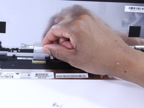

  23. HP Pavilion x360 m3-u001dx Display Replacement: crwdns2935265:023crwdnd2935265:01crwdnd2935265:02crwdne2935265:0 HP Pavilion x360 m3-u001dx Display Replacement: crwdns2935265:023crwdnd2935265:02crwdnd2935265:02crwdne2935265:0
    • Peel off the adhesive tape and remove the connected cable from the screen.
  24. HP Pavilion x360 m3-u001dx Display Replacement: crwdns2935265:024crwdnd2935265:01crwdnd2935265:02crwdne2935265:0 HP Pavilion x360 m3-u001dx Display Replacement: crwdns2935265:024crwdnd2935265:02crwdnd2935265:02crwdne2935265:0
    • Lift the circuit board out of the way to expose the wire underneath. Remove the wire from the base of the laptop.
