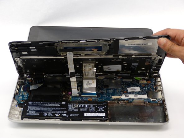

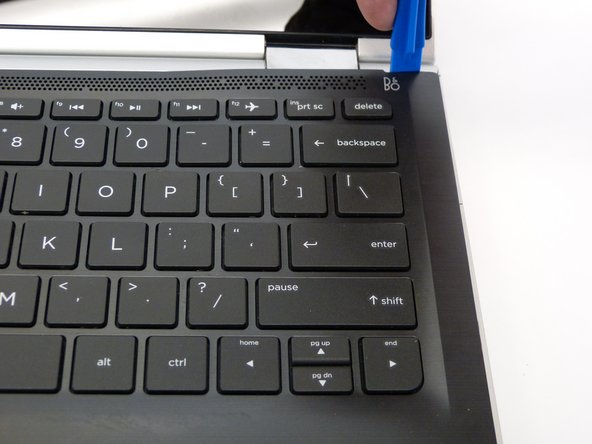

    • Flip the laptop back over and open it; the keyboard should be facing upwards.
    • Using the Plastic Opening Tool, separate the keyboard from the base of the laptop.
    • The keyboard is connected to the motherboard with cable ribbons, so be very gentle and careful when lifting the keyboard.
  5. HP Pavilion x360 m1-u001dx Speaker Replacement: crwdns2935265:05crwdnd2935265:01crwdnd2935265:03crwdne2935265:0 HP Pavilion x360 m1-u001dx Speaker Replacement: crwdns2935265:05crwdnd2935265:02crwdnd2935265:03crwdne2935265:0 HP Pavilion x360 m1-u001dx Speaker Replacement: crwdns2935265:05crwdnd2935265:03crwdnd2935265:03crwdne2935265:0
    Heavy-Duty Spudger

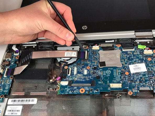

    • Raising the keyboard, disconnect the first of two cable ribbons with the Heavy-Duty Spudger.
    • Gently flip up the white plastic lock connecting the ribbon cable to the motherboard.
    • Use the blue plastic tab on the ribbon cable to disconnect the ribbon cable from the lock.
  6. HP Pavilion x360 m1-u001dx Speaker Replacement: crwdns2935265:06crwdnd2935265:01crwdnd2935265:02crwdne2935265:0 HP Pavilion x360 m1-u001dx Speaker Replacement: crwdns2935265:06crwdnd2935265:02crwdnd2935265:02crwdne2935265:0
    • Gently flip up the white plastic lock connecting the second ribbon cable to the motherboard with the Heavy-Duty Spudger.
    • Use the blue purple tab on the ribbon cable to disconnect the ribbon cable from the lock.
  7. HP Pavilion x360 m1-u001dx Speaker Replacement: crwdns2935265:07crwdnd2935265:01crwdnd2935265:02crwdne2935265:0 HP Pavilion x360 m1-u001dx Speaker Replacement: crwdns2935265:07crwdnd2935265:02crwdnd2935265:02crwdne2935265:0
    • After the ribbon cables are disconnected, gently lift up the keyboard to disconnect it from the base of the laptop.

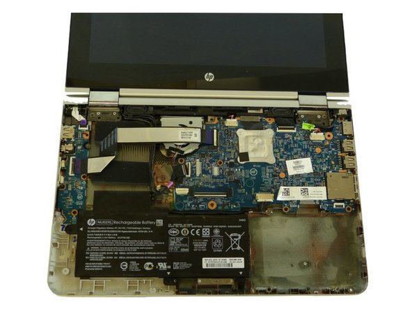

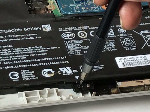

  8. HP Pavilion x360 m1-u001dx Speaker Replacement, Battery: crwdns2935265:08crwdnd2935265:01crwdnd2935265:03crwdne2935265:0 HP Pavilion x360 m1-u001dx Speaker Replacement, Battery: crwdns2935265:08crwdnd2935265:02crwdnd2935265:03crwdne2935265:0 HP Pavilion x360 m1-u001dx Speaker Replacement, Battery: crwdns2935265:08crwdnd2935265:03crwdnd2935265:03crwdne2935265:0

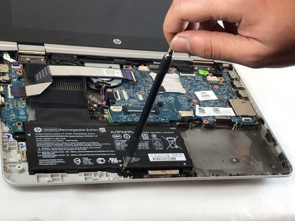

    • Remove the screws from the perimeter of the battery with a Phillips 00 Screwdriver.
    • 3 Phillips 2.0 x 4.6 mm screws
    • Keep the different sized screws separate for future replacement.
  9. HP Pavilion x360 m1-u001dx Speaker Replacement: crwdns2935265:09crwdnd2935265:01crwdnd2935265:02crwdne2935265:0 HP Pavilion x360 m1-u001dx Speaker Replacement: crwdns2935265:09crwdnd2935265:02crwdnd2935265:02crwdne2935265:0

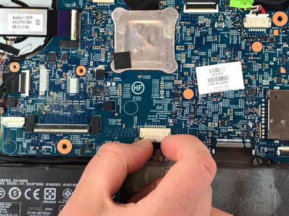

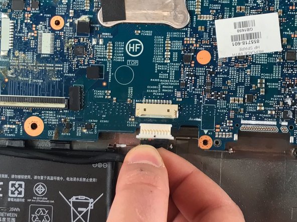

    • Holding the lower right corner, gently lift up the battery to disconnect it from the motherboard.
  10. HP Pavilion x360 m1-u001dx Speaker Replacement, System Board (Motherboard): crwdns2935265:010crwdnd2935265:01crwdnd2935265:02crwdne2935265:0 HP Pavilion x360 m1-u001dx Speaker Replacement, System Board (Motherboard): crwdns2935265:010crwdnd2935265:02crwdnd2935265:02crwdne2935265:0

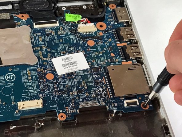

    • Remove the screws from the perimeter of the motherboard with a Phillips 00 Screwdriver.
    • 8 Phillips 2.0 x 4.7 mm screws.

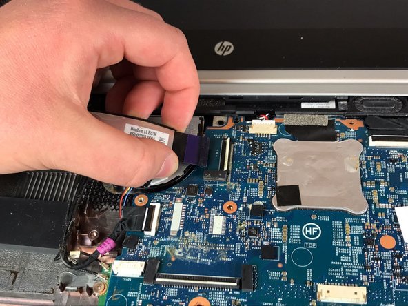

  11. HP Pavilion x360 m1-u001dx Speaker Replacement: crwdns2935265:011crwdnd2935265:01crwdnd2935265:03crwdne2935265:0 HP Pavilion x360 m1-u001dx Speaker Replacement: crwdns2935265:011crwdnd2935265:02crwdnd2935265:03crwdne2935265:0 HP Pavilion x360 m1-u001dx Speaker Replacement: crwdns2935265:011crwdnd2935265:03crwdnd2935265:03crwdne2935265:0
    • Disconnect the 3 bundle cable connectors by gently gripping the cable wires and pulling outwards.
    • Be sure to grip each of the cables equally so no single cable is overly strained.
  12. HP Pavilion x360 m1-u001dx Speaker Replacement: crwdns2935265:012crwdnd2935265:01crwdnd2935265:03crwdne2935265:0 HP Pavilion x360 m1-u001dx Speaker Replacement: crwdns2935265:012crwdnd2935265:02crwdnd2935265:03crwdne2935265:0 HP Pavilion x360 m1-u001dx Speaker Replacement: crwdns2935265:012crwdnd2935265:03crwdnd2935265:03crwdne2935265:0
    Heavy-Duty Spudger

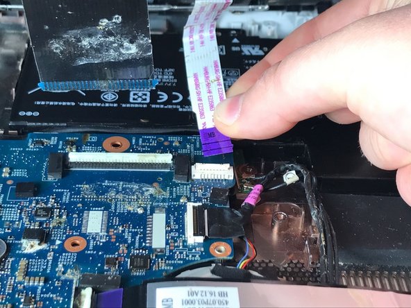

    • Disconnect the 2 cable ribbons with the Heavy-Duty Spudger.
    • Use the purple plastic tab on the ribbon cable to disconnect the ribbon cable from the lock.

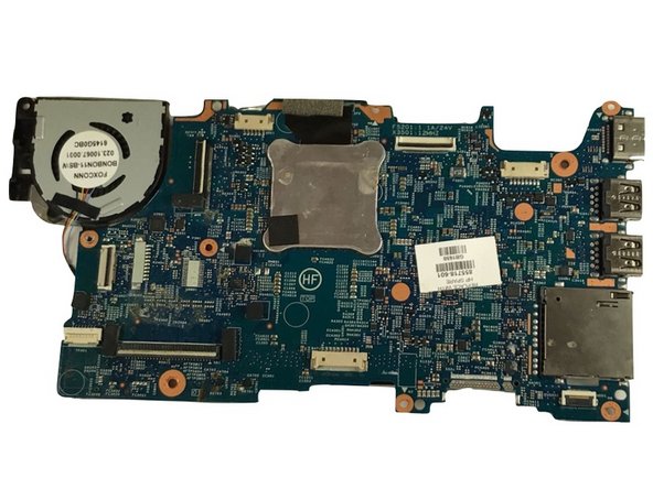

  13. HP Pavilion x360 m1-u001dx Speaker Replacement: crwdns2935265:013crwdnd2935265:01crwdnd2935265:03crwdne2935265:0 HP Pavilion x360 m1-u001dx Speaker Replacement: crwdns2935265:013crwdnd2935265:02crwdnd2935265:03crwdne2935265:0 HP Pavilion x360 m1-u001dx Speaker Replacement: crwdns2935265:013crwdnd2935265:03crwdnd2935265:03crwdne2935265:0

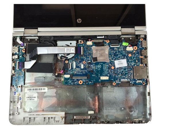

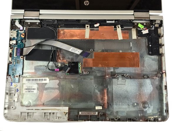

    • Gently lift up the motherboard to disconnect it from the computer.

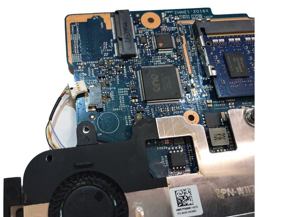

  14. HP Pavilion x360 m1-u001dx Speaker Replacement, Fan: crwdns2935265:014crwdnd2935265:01crwdnd2935265:03crwdne2935265:0 HP Pavilion x360 m1-u001dx Speaker Replacement, Fan: crwdns2935265:014crwdnd2935265:02crwdnd2935265:03crwdne2935265:0 HP Pavilion x360 m1-u001dx Speaker Replacement, Fan: crwdns2935265:014crwdnd2935265:03crwdnd2935265:03crwdne2935265:0

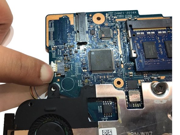

    • Disconnect the bundle cable connector by gently gripping the cable wires and pulling outwards.

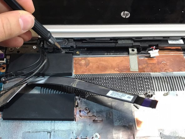

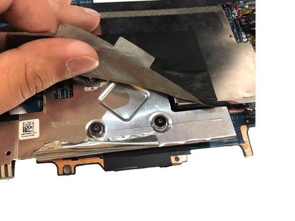

  15. HP Pavilion x360 m1-u001dx Speaker Replacement: crwdns2935265:015crwdnd2935265:01crwdnd2935265:02crwdne2935265:0 HP Pavilion x360 m1-u001dx Speaker Replacement: crwdns2935265:015crwdnd2935265:02crwdnd2935265:02crwdne2935265:0
    • Peel off the black sticker to expose the screws underneath.
    • Do not crumple the sticker; you will need it when reassembling the fan.
  16. HP Pavilion x360 m1-u001dx Speaker Replacement: crwdns2935265:016crwdnd2935265:01crwdnd2935265:01crwdne2935265:0
    • Remove the 4 screws from the motherboard with a Phillips 00 Screwdriver.
    • 4 Phillips 2.5 x 5.5 mm screws
    • Keep the screws for future replacement.
  17. HP Pavilion x360 m1-u001dx Speaker Replacement: crwdns2935265:017crwdnd2935265:01crwdnd2935265:01crwdne2935265:0
    • Disconnect the fan from the motherboard by taking out the screws.

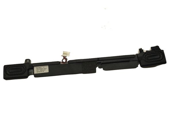

  18. HP Pavilion x360 m1-u001dx Speaker Replacement, Speaker: crwdns2935265:018crwdnd2935265:01crwdnd2935265:02crwdne2935265:0 HP Pavilion x360 m1-u001dx Speaker Replacement, Speaker: crwdns2935265:018crwdnd2935265:02crwdnd2935265:02crwdne2935265:0
    • Remove the screws from the sound piece with a Phillips 00 Screwdriver.
    • 2 Phillips 2.4 x 5.7 mm screws
  19. HP Pavilion x360 m1-u001dx Speaker Replacement: crwdns2935265:019crwdnd2935265:01crwdnd2935265:02crwdne2935265:0 HP Pavilion x360 m1-u001dx Speaker Replacement: crwdns2935265:019crwdnd2935265:02crwdnd2935265:02crwdne2935265:0
    • After the screws are out, lift out the speaker from the base of the laptop.
