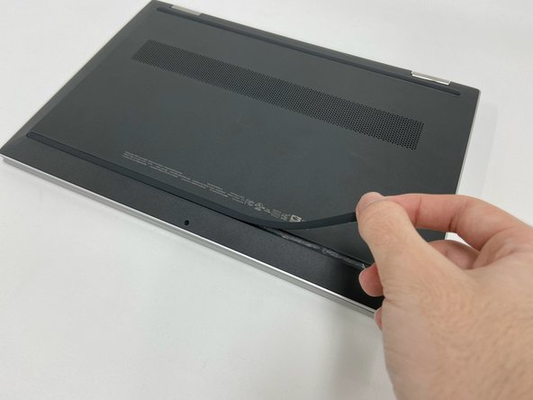

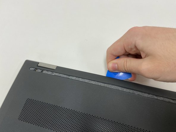

    • Turn off the device and set it upside down. Orient the hinges away from you.
    • Wedge the opening pick under the grip. Lift the end of the grip.
    • Pull the grip off all the way. Repeat for the second grip.

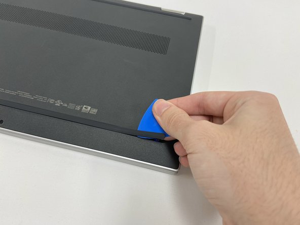

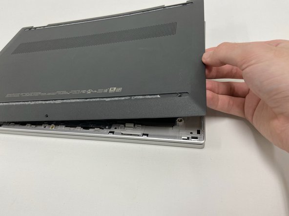

    • Use the opening pick to separate the back panel from the device.
    • Begin near the hinge and carefully follow the perimeter until you have taken the pick around all four sides.
    • The back panel will come loose once the pick has been around the whole edge of the device.
    • Lift the panel off.

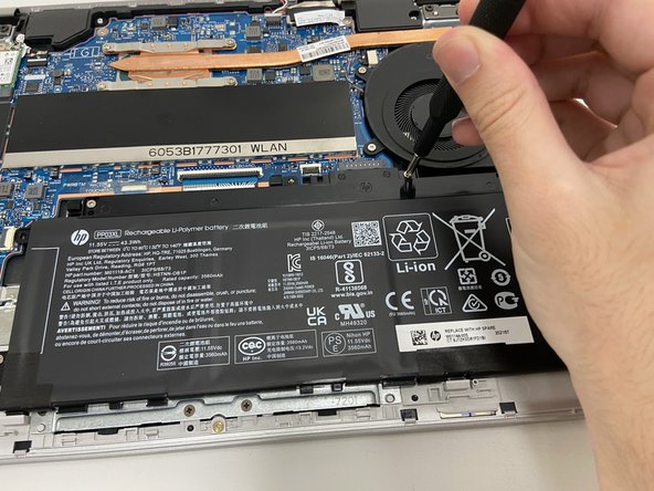

    • Use a Phillips #1 screwdriver to remove all four of the 4 mm screws that secure each corner of the battery.

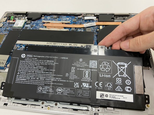

  5. HP Pavilion x360 Convertible 14-dw1025nr Trackpad Replacement: crwdns2935265:05crwdnd2935265:01crwdnd2935265:03crwdne2935265:0 HP Pavilion x360 Convertible 14-dw1025nr Trackpad Replacement: crwdns2935265:05crwdnd2935265:02crwdnd2935265:03crwdne2935265:0 HP Pavilion x360 Convertible 14-dw1025nr Trackpad Replacement: crwdns2935265:05crwdnd2935265:03crwdnd2935265:03crwdne2935265:0

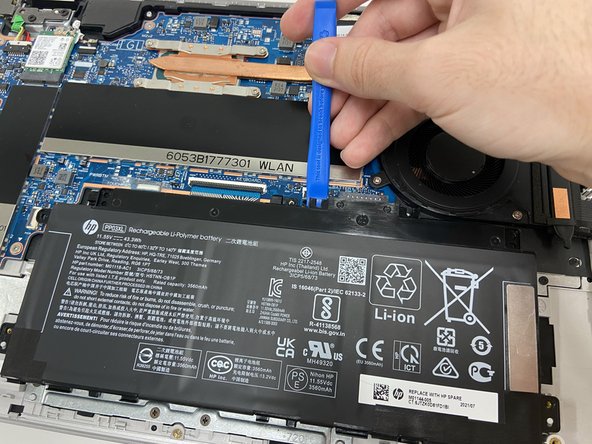

    • Use the opening tool near the connector to gently apply pressure and lift the battery away from the device.
    • Once loose, lift the battery from the connector side to separate it from the device.
    • The stabilizer for the battery (small black part held in by the top left screw) may come loose. Leave the part in its original position.

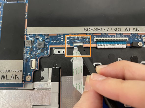

    $3.99

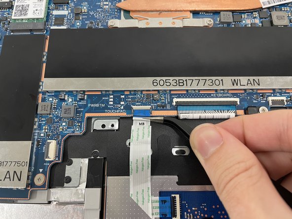

    • To unplug the trackpad, remove both stickers with angled tweezers.
    • Lift the connector clasp with spudger.
    • Use angled tweezers to lightly grip the ribbon cable and pull it out to lift cable off of black cover
  12. HP Pavilion x360 Convertible 14-dw1025nr Trackpad Replacement: crwdns2935265:012crwdnd2935265:01crwdnd2935265:02crwdne2935265:0 HP Pavilion x360 Convertible 14-dw1025nr Trackpad Replacement: crwdns2935265:012crwdnd2935265:02crwdnd2935265:02crwdne2935265:0

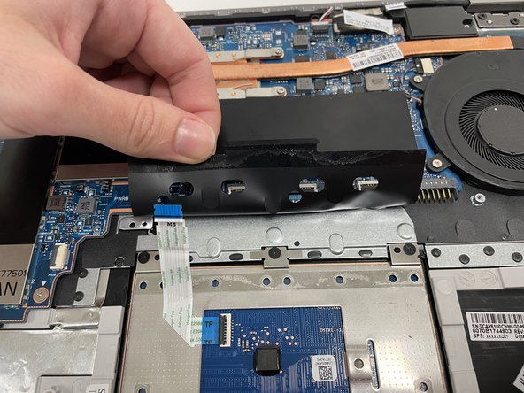

    • Using the angled tweezers, grip one corner of the black cover and lift.
  13. HP Pavilion x360 Convertible 14-dw1025nr Trackpad Replacement: crwdns2935265:013crwdnd2935265:01crwdnd2935265:01crwdne2935265:0
    • Hold back the black cover with one hand.
    • Use the PH0 screwdriver to remove three black screws (2.5mm) located at the top of the trackpad.

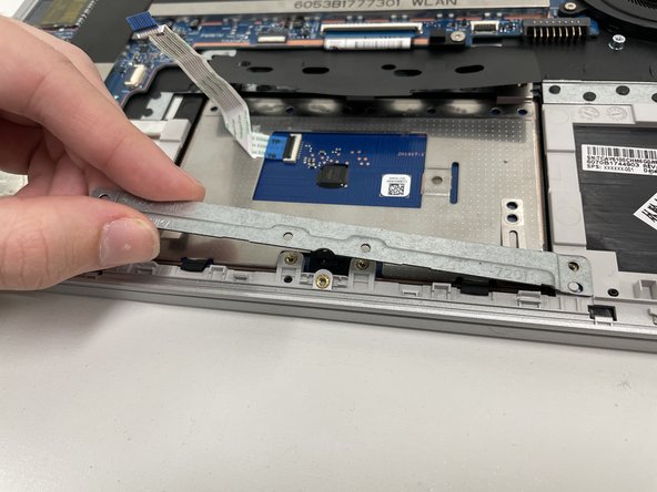

  15. HP Pavilion x360 Convertible 14-dw1025nr Trackpad Replacement: crwdns2935265:015crwdnd2935265:01crwdnd2935265:03crwdne2935265:0 HP Pavilion x360 Convertible 14-dw1025nr Trackpad Replacement: crwdns2935265:015crwdnd2935265:02crwdnd2935265:03crwdne2935265:0 HP Pavilion x360 Convertible 14-dw1025nr Trackpad Replacement: crwdns2935265:015crwdnd2935265:03crwdnd2935265:03crwdne2935265:0
    • Hold back the black cover.
    • Use the angled tweezers to grip the metal screw tab located in the middle of the trackpad.
    • Lift up and away to remove the trackpad part.
