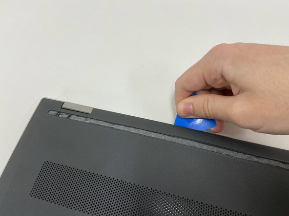

    • Turn off the device and set it upside down. Orient the hinges away from you.
    • Wedge the opening pick under the grip. Lift the end of the grip.
    • Pull the grip off all the way. Repeat for the second grip.

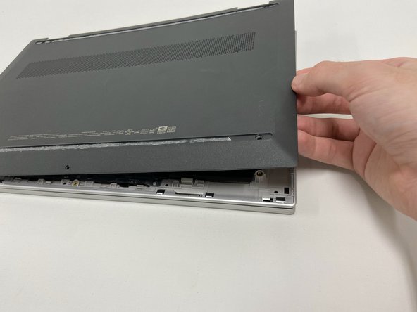

  3. HP Pavilion x360 Convertible 14-dw1025nr Solid-State Drive (SSD) Replacement: crwdns2935265:03crwdnd2935265:01crwdnd2935265:03crwdne2935265:0 HP Pavilion x360 Convertible 14-dw1025nr Solid-State Drive (SSD) Replacement: crwdns2935265:03crwdnd2935265:02crwdnd2935265:03crwdne2935265:0 HP Pavilion x360 Convertible 14-dw1025nr Solid-State Drive (SSD) Replacement: crwdns2935265:03crwdnd2935265:03crwdnd2935265:03crwdne2935265:0
    • Use the opening pick to separate the back panel from the device.
    • Begin near the hinge and carefully follow the perimeter until you have taken the pick around all four sides.
    • The back panel will come loose once the pick has been around the whole edge of the device.
    • Lift the panel off.

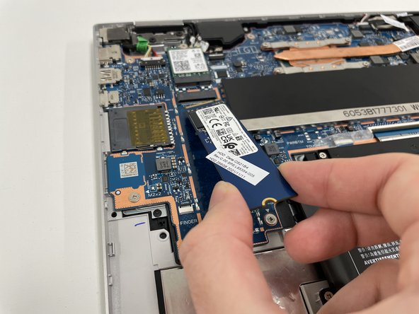

  6. HP Pavilion x360 Convertible 14-dw1025nr Solid-State Drive (SSD) Replacement: crwdns2935265:06crwdnd2935265:01crwdnd2935265:02crwdne2935265:0 HP Pavilion x360 Convertible 14-dw1025nr Solid-State Drive (SSD) Replacement: crwdns2935265:06crwdnd2935265:02crwdnd2935265:02crwdne2935265:0
    • Pull the SSD out and up, away from the connector.
