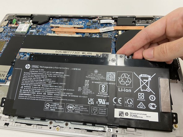

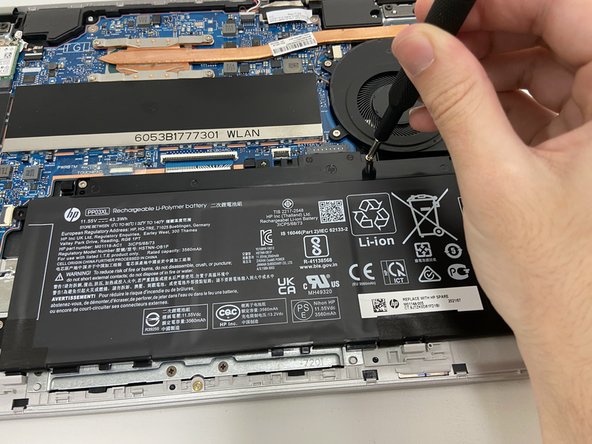

    • Use a Phillips #1 screwdriver to remove all four of the 4 mm screws that secure each corner of the battery.
  5. HP Pavilion x360 Convertible 14-dw1025nr Battery Replacement: crwdns2935265:05crwdnd2935265:01crwdnd2935265:03crwdne2935265:0 HP Pavilion x360 Convertible 14-dw1025nr Battery Replacement: crwdns2935265:05crwdnd2935265:02crwdnd2935265:03crwdne2935265:0 HP Pavilion x360 Convertible 14-dw1025nr Battery Replacement: crwdns2935265:05crwdnd2935265:03crwdnd2935265:03crwdne2935265:0

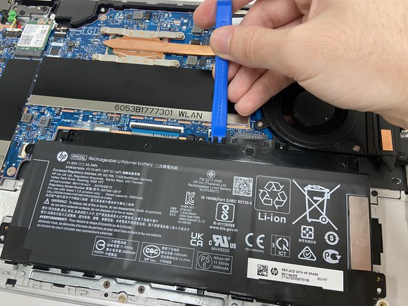

    • Use the opening tool near the connector to gently apply pressure and lift the battery away from the device.
    • Once loose, lift the battery from the connector side to separate it from the device.
    • The stabilizer for the battery (small black part held in by the top left screw) may come loose. Leave the part in its original position.

Guide is also useful for HP Envy x360 convertible! There is just two more T2 screws in step 1. Also there is a cable next to the battery which is run alongside the battery. This has to be removed carefully before swapping it out.
