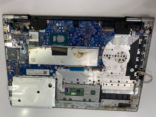

  17. HP Pavilion x360 14m-cd0005dx Speaker Replacement, Speaker: crwdns2935265:017crwdnd2935265:01crwdnd2935265:02crwdne2935265:0 HP Pavilion x360 14m-cd0005dx Speaker Replacement, Speaker: crwdns2935265:017crwdnd2935265:02crwdnd2935265:02crwdne2935265:0
    • Flip the device over so the hinge is at the top and the motherboard, and other components are visible.
  18. HP Pavilion x360 14m-cd0005dx Speaker Replacement: crwdns2935265:018crwdnd2935265:01crwdnd2935265:03crwdne2935265:0 HP Pavilion x360 14m-cd0005dx Speaker Replacement: crwdns2935265:018crwdnd2935265:02crwdnd2935265:03crwdne2935265:0 HP Pavilion x360 14m-cd0005dx Speaker Replacement: crwdns2935265:018crwdnd2935265:03crwdnd2935265:03crwdne2935265:0
    • Use the Reverse Tweezers to remove the ribbon wires connecting the speaker to the motherboard.
  19. HP Pavilion x360 14m-cd0005dx Speaker Replacement: crwdns2935265:019crwdnd2935265:01crwdnd2935265:02crwdne2935265:0 HP Pavilion x360 14m-cd0005dx Speaker Replacement: crwdns2935265:019crwdnd2935265:02crwdnd2935265:02crwdne2935265:0
    • Grab the ribbon wires by the edge of the socket and pull to remove the wire connecting the speaker to the motherboard.
    • Grand and pull to remove the wire connecting the speaker to the wireless card housing.
  20. HP Pavilion x360 14m-cd0005dx Speaker Replacement: crwdns2935265:020crwdnd2935265:01crwdnd2935265:03crwdne2935265:0 HP Pavilion x360 14m-cd0005dx Speaker Replacement: crwdns2935265:020crwdnd2935265:02crwdnd2935265:03crwdne2935265:0 HP Pavilion x360 14m-cd0005dx Speaker Replacement: crwdns2935265:020crwdnd2935265:03crwdnd2935265:03crwdne2935265:0
    • Grab the speaker and pull out to remove the speakers from the hinge housing.
    • The disconnected wires may be slightly tangled within the housing. Grab and pull gently to remove from the enclosure.
