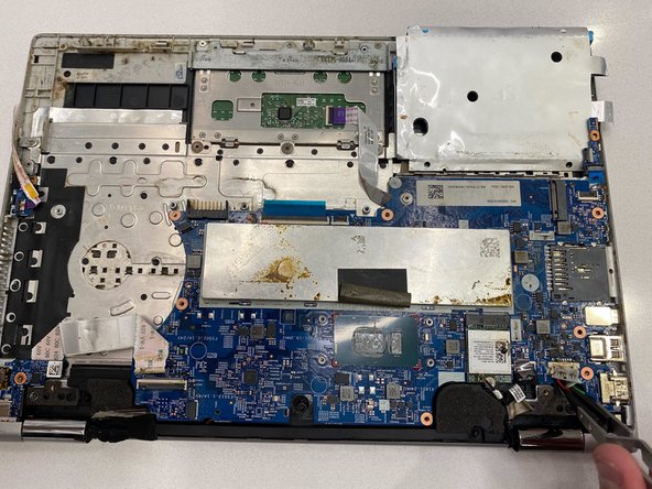

    • Remove all screws securing the motherboard to the device:
    • Ten Phillips #0 4.5mm screws
  13. HP Pavilion x360 14m-cd0005dx Motherboard Replacement: crwdns2935265:013crwdnd2935265:01crwdnd2935265:03crwdne2935265:0 HP Pavilion x360 14m-cd0005dx Motherboard Replacement: crwdns2935265:013crwdnd2935265:02crwdnd2935265:03crwdne2935265:0 HP Pavilion x360 14m-cd0005dx Motherboard Replacement: crwdns2935265:013crwdnd2935265:03crwdnd2935265:03crwdne2935265:0

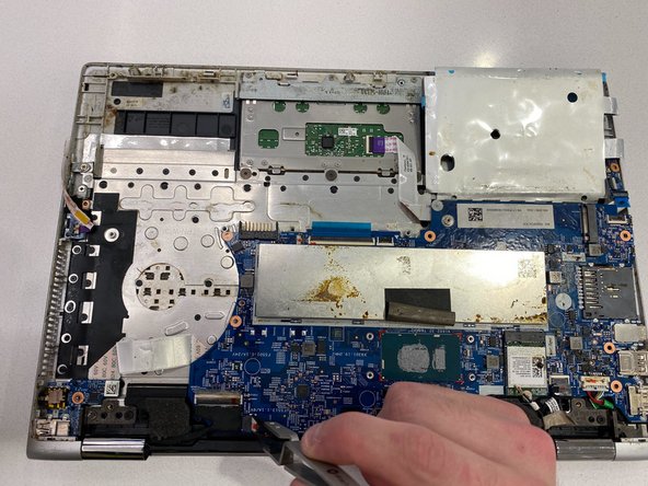

    • Use the Reverse Tweezers to disconnect the speaker cables from the motherboard.
  14. HP Pavilion x360 14m-cd0005dx Motherboard Replacement: crwdns2935265:014crwdnd2935265:01crwdnd2935265:02crwdne2935265:0 HP Pavilion x360 14m-cd0005dx Motherboard Replacement: crwdns2935265:014crwdnd2935265:02crwdnd2935265:02crwdne2935265:0
    • Slide out the ribbon wire from the motherboard
  15. HP Pavilion x360 14m-cd0005dx Motherboard Replacement: crwdns2935265:015crwdnd2935265:01crwdnd2935265:02crwdne2935265:0 HP Pavilion x360 14m-cd0005dx Motherboard Replacement: crwdns2935265:015crwdnd2935265:02crwdnd2935265:02crwdne2935265:0
    • Gently lift the motherboard out of the device
