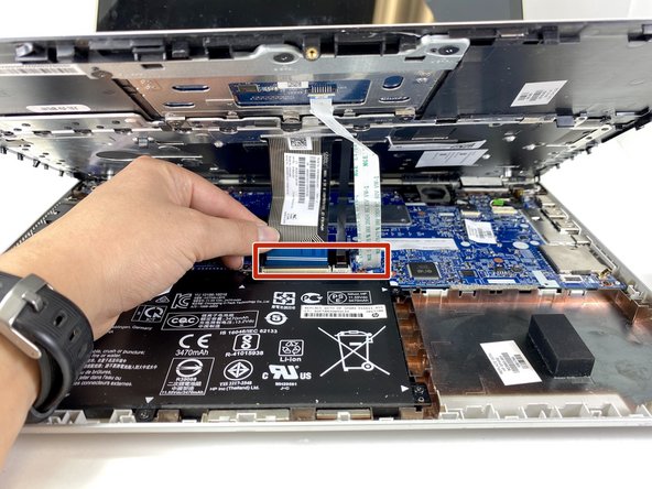

    • Separate the keyboard from the rest of the device using a metal spudger around edges.
    • Pull up gently until you can see the cables attaching the keyboard to the motherboard.
    • Flip the small white clasps that hold the three cables to the motherboard open and unplug the cables.

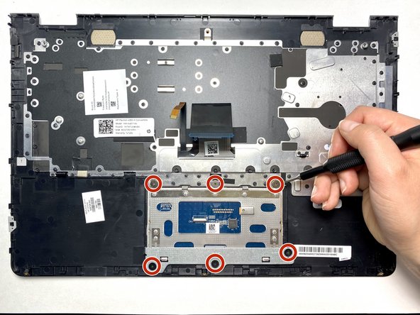

    • Flip the now removed keyboard over to expose the bottom side.
    • Unclasp the cable that connects the touchpad to the keyboard.
    • You can remove this cable the same way you removed the previous cables.
    • Remove the six 2.3 mm screws that attach the touch pad using a Phillips #00 Screwdriver.

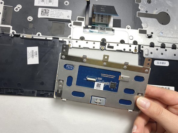

  5. HP Pavilion x360 14m-ba011dx Touchpad Replacement: crwdns2935265:05crwdnd2935265:01crwdnd2935265:02crwdne2935265:0 HP Pavilion x360 14m-ba011dx Touchpad Replacement: crwdns2935265:05crwdnd2935265:02crwdnd2935265:02crwdne2935265:0
    • Pull off the metal piece holding the touchpad in place.
    • Remove the touchpad from the device.
