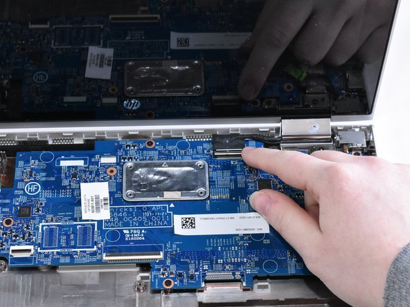

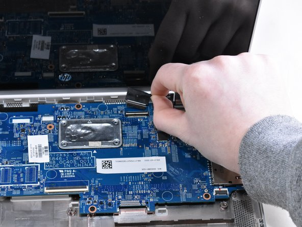

    • Using your fingernail, disconnect the ZIF display panel connector cable from the motherboard.

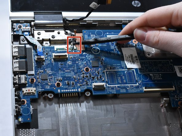

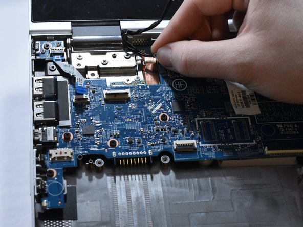

  18. HP Pavilion x360 11m-ad013dx Heat Sink Replacement: crwdns2935265:018crwdnd2935265:01crwdnd2935265:03crwdne2935265:0 HP Pavilion x360 11m-ad013dx Heat Sink Replacement: crwdns2935265:018crwdnd2935265:02crwdnd2935265:03crwdne2935265:0 HP Pavilion x360 11m-ad013dx Heat Sink Replacement: crwdns2935265:018crwdnd2935265:03crwdnd2935265:03crwdne2935265:0
    • Disconnect the two WLAN antenna cables by sliding under the cable with a spudger, then lifting straight up.
    • The black labeled cable inserts into the "A" connection. The white labeled cable inserts into the "B" connection.

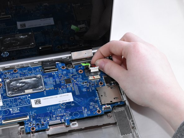

  19. HP Pavilion x360 11m-ad013dx Heat Sink Replacement: crwdns2935265:019crwdnd2935265:01crwdnd2935265:03crwdne2935265:0 HP Pavilion x360 11m-ad013dx Heat Sink Replacement: crwdns2935265:019crwdnd2935265:02crwdnd2935265:03crwdne2935265:0 HP Pavilion x360 11m-ad013dx Heat Sink Replacement: crwdns2935265:019crwdnd2935265:03crwdnd2935265:03crwdne2935265:0

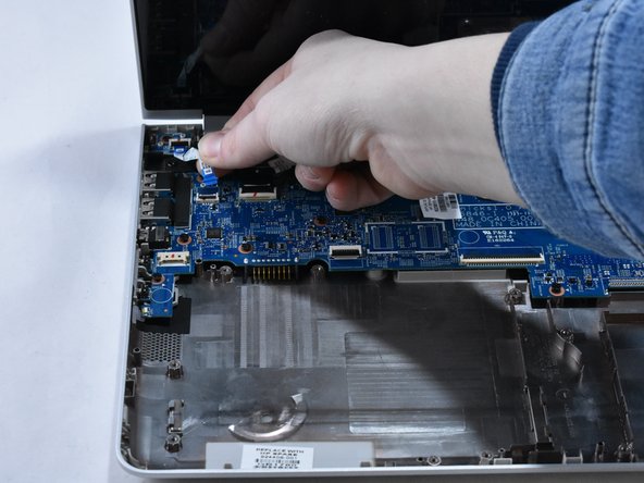

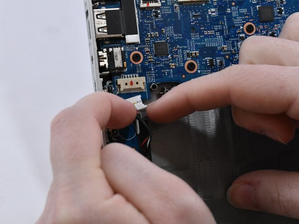

    • Using your fingernail, disconnect the ZIF display touch screen connector cable from the motherboard.
  20. HP Pavilion x360 11m-ad013dx Heat Sink Replacement: crwdns2935265:020crwdnd2935265:01crwdnd2935265:02crwdne2935265:0 HP Pavilion x360 11m-ad013dx Heat Sink Replacement: crwdns2935265:020crwdnd2935265:02crwdnd2935265:02crwdne2935265:0
    • Using your fingernails, disconnect the power connector cable by pulling straight out.
    • Do not directly pull the wires, as this can damage the connector. Instead, pull on the white, plastic part of the connector.

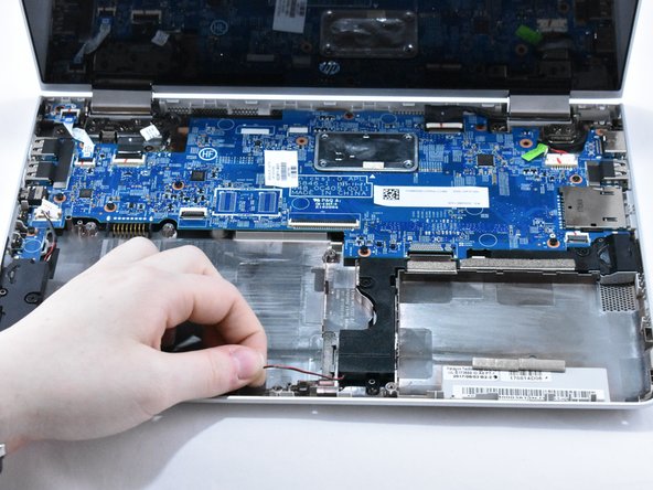

  23. HP Pavilion x360 11m-ad013dx Heat Sink Replacement: crwdns2935265:023crwdnd2935265:01crwdnd2935265:01crwdne2935265:0
    • Lift the motherboard up on the right side. Then, gently pull the motherboard straight out to the right.

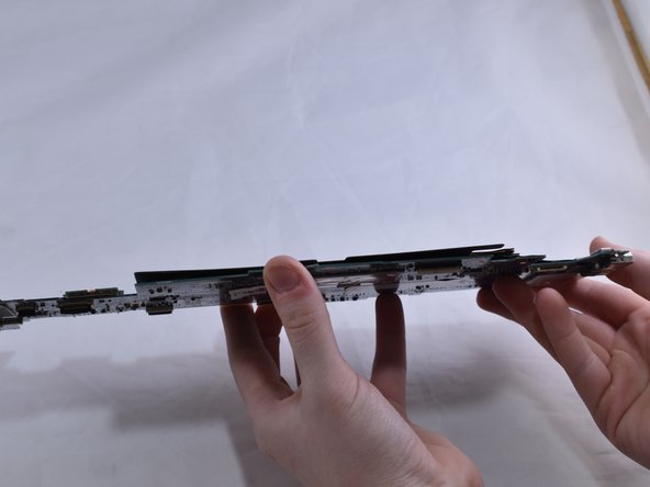

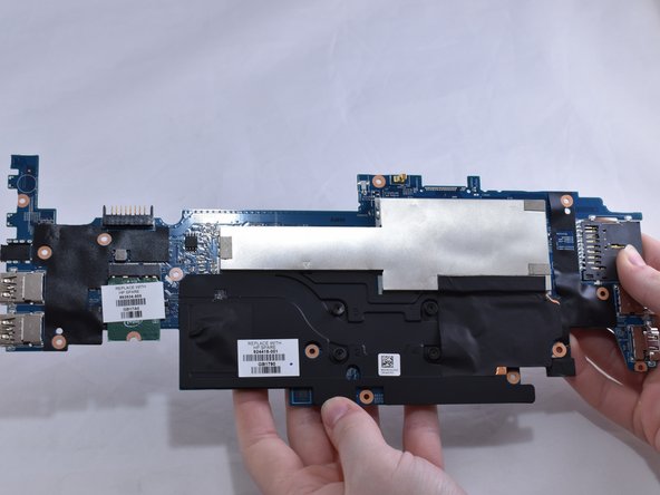

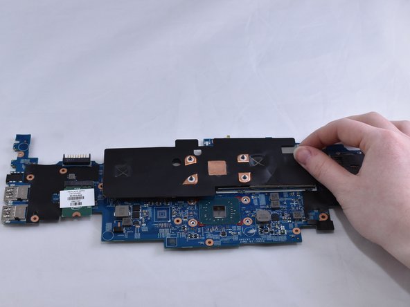

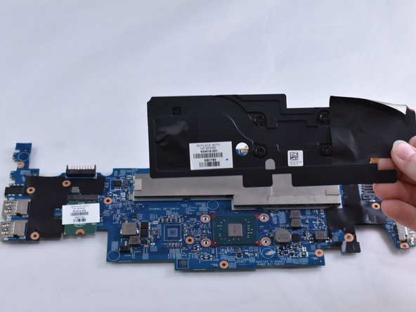

  24. HP Pavilion x360 11m-ad013dx Heat Sink Replacement, Heat Sink: crwdns2935265:024crwdnd2935265:01crwdnd2935265:03crwdne2935265:0 HP Pavilion x360 11m-ad013dx Heat Sink Replacement, Heat Sink: crwdns2935265:024crwdnd2935265:02crwdnd2935265:03crwdne2935265:0 HP Pavilion x360 11m-ad013dx Heat Sink Replacement, Heat Sink: crwdns2935265:024crwdnd2935265:03crwdnd2935265:03crwdne2935265:0
    • Flip the motherboard over towards you.
  25. HP Pavilion x360 11m-ad013dx Heat Sink Replacement: crwdns2935265:025crwdnd2935265:01crwdnd2935265:03crwdne2935265:0 HP Pavilion x360 11m-ad013dx Heat Sink Replacement: crwdns2935265:025crwdnd2935265:02crwdnd2935265:03crwdne2935265:0 HP Pavilion x360 11m-ad013dx Heat Sink Replacement: crwdns2935265:025crwdnd2935265:03crwdnd2935265:03crwdne2935265:0
    • Loosen the four captive Phillips #1 screws.
    • Do not attempt to remove the captive screws; only loosen them.
    • Flip the heat sink up.

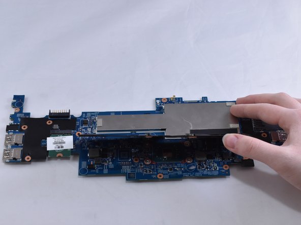

  26. HP Pavilion x360 11m-ad013dx Heat Sink Replacement: crwdns2935265:026crwdnd2935265:01crwdnd2935265:01crwdne2935265:0
    • Using a tissue or paper towel, clean thermal paste off the heat sink and processor.
    • New thermal paste, along with instructions for how to apply the paste, is provided with the purchased replacement heat sink.
  27. HP Pavilion x360 11m-ad013dx Heat Sink Replacement: crwdns2935265:027crwdnd2935265:01crwdnd2935265:02crwdne2935265:0 HP Pavilion x360 11m-ad013dx Heat Sink Replacement: crwdns2935265:027crwdnd2935265:02crwdnd2935265:02crwdne2935265:0
    • Remove the black electric tape attached to the shell of the memory module.
