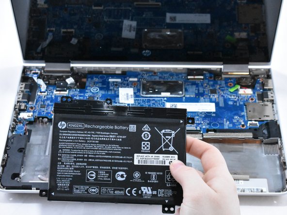

  9. HP Pavilion x360 11m-ad013dx Battery Replacement, Battery: crwdns2935265:09crwdnd2935265:01crwdnd2935265:01crwdne2935265:0
    • Remove the five 4.6mm Phillips #1 screws located around the battery.
  10. HP Pavilion x360 11m-ad013dx Battery Replacement: crwdns2935265:010crwdnd2935265:01crwdnd2935265:02crwdne2935265:0 HP Pavilion x360 11m-ad013dx Battery Replacement: crwdns2935265:010crwdnd2935265:02crwdnd2935265:02crwdne2935265:0
    • Using a spudger for assistance, lift up the right edge of the battery.
    • Remove the battery.
