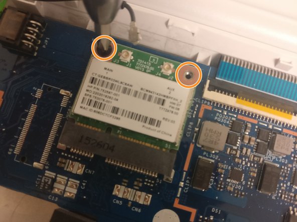

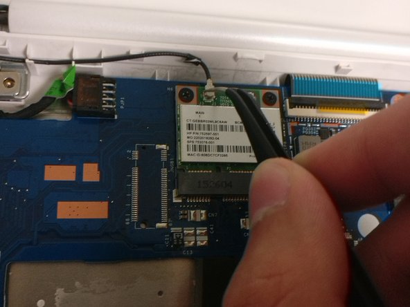

    • The wireless chip is square shaped, with white paper containing bar codes glued to it. The chip is in the top left section of the back (with the hinged edge facing away from you)
    • The chip will have a single wire connected to it. Carefully remove the wire connected to the chip using tweezers.
    • Unscrew the two screws near the top.
  4. HP Pavilion x360 11-p110nr Wireless Chip Replacement: crwdns2935265:04crwdnd2935265:01crwdnd2935265:01crwdne2935265:0
    • Remove the old chip and insert the new one in place.
    • When re-inserting the screws, be cautious as you do not want to strip the screws.
