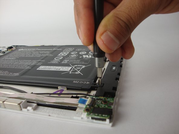

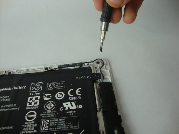

  5. HP Pavilion x2 10-n113dx Speaker Replacement: crwdns2935265:05crwdnd2935265:01crwdnd2935265:03crwdne2935265:0 HP Pavilion x2 10-n113dx Speaker Replacement: crwdns2935265:05crwdnd2935265:02crwdnd2935265:03crwdne2935265:0 HP Pavilion x2 10-n113dx Speaker Replacement: crwdns2935265:05crwdnd2935265:03crwdnd2935265:03crwdne2935265:0
    • Using the Phillips #0 screwdriver, carefully remove the 4 corner screws that hold the battery to the display panel.
    • 3 screws are 3.12 mm head, 2.40 mm length, and 1 screw is 5.85mm head, 2.5mm length.
    • Remove the battery from the device.

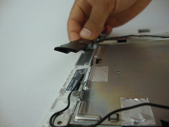

  6. HP Pavilion x2 10-n113dx Speaker Replacement, Speaker: crwdns2935265:06crwdnd2935265:01crwdnd2935265:03crwdne2935265:0 HP Pavilion x2 10-n113dx Speaker Replacement, Speaker: crwdns2935265:06crwdnd2935265:02crwdnd2935265:03crwdne2935265:0 HP Pavilion x2 10-n113dx Speaker Replacement, Speaker: crwdns2935265:06crwdnd2935265:03crwdnd2935265:03crwdne2935265:0
    • To unscrew the first speaker, use the Phillips #0 screwdriver to unscrew the 2 screws- head 3.99mm, length 3.32 mm.

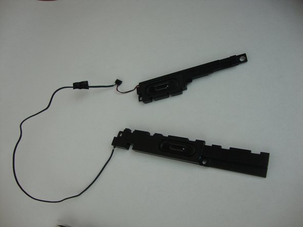

  8. HP Pavilion x2 10-n113dx Speaker Replacement: crwdns2935265:08crwdnd2935265:01crwdnd2935265:03crwdne2935265:0 HP Pavilion x2 10-n113dx Speaker Replacement: crwdns2935265:08crwdnd2935265:02crwdnd2935265:03crwdne2935265:0 HP Pavilion x2 10-n113dx Speaker Replacement: crwdns2935265:08crwdnd2935265:03crwdnd2935265:03crwdne2935265:0
    • Gently remove the 1st and 2nd speaker from the assembly.
