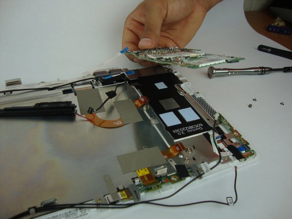

    • Before starting, please turn off your laptop.
    • Using the blue plastic opening tool or a flat bladed tool, carefully slide the blade in between the display panel and gently slide to prop open the assembly.
  2. HP Pavilion x2 10-n113dx  Mainboard Replacement: crwdns2935265:02crwdnd2935265:01crwdnd2935265:02crwdne2935265:0 HP Pavilion x2 10-n113dx  Mainboard Replacement: crwdns2935265:02crwdnd2935265:02crwdnd2935265:02crwdne2935265:0
    • Gently lift and remove the display panel from the assembly.
    • Remove the translucent yellow tape that covers the battery connector on the mainboard.
    • The tape will be in the way for a future step.
  3. HP Pavilion x2 10-n113dx  Mainboard Replacement: crwdns2935265:03crwdnd2935265:01crwdnd2935265:03crwdne2935265:0 HP Pavilion x2 10-n113dx  Mainboard Replacement: crwdns2935265:03crwdnd2935265:02crwdnd2935265:03crwdne2935265:0 HP Pavilion x2 10-n113dx  Mainboard Replacement: crwdns2935265:03crwdnd2935265:03crwdnd2935265:03crwdne2935265:0
    • Flip up the small white colored locking flap using the tip of a spudger or your fingernail. Then the ribbon cable can be removed easily without much effort.
    • Carefully disconnect the white ribbon cable from the mainboard.
  4. HP Pavilion x2 10-n113dx  Mainboard Replacement: crwdns2935265:04crwdnd2935265:01crwdnd2935265:03crwdne2935265:0 HP Pavilion x2 10-n113dx  Mainboard Replacement: crwdns2935265:04crwdnd2935265:02crwdnd2935265:03crwdne2935265:0 HP Pavilion x2 10-n113dx  Mainboard Replacement: crwdns2935265:04crwdnd2935265:03crwdnd2935265:03crwdne2935265:0
    • Carefully disconnect the battery cable from its connector on the mainboard.
  5. HP Pavilion x2 10-n113dx  Mainboard Replacement: crwdns2935265:05crwdnd2935265:01crwdnd2935265:03crwdne2935265:0 HP Pavilion x2 10-n113dx  Mainboard Replacement: crwdns2935265:05crwdnd2935265:02crwdnd2935265:03crwdne2935265:0 HP Pavilion x2 10-n113dx  Mainboard Replacement: crwdns2935265:05crwdnd2935265:03crwdnd2935265:03crwdne2935265:0
    • Using the Phillips #0 screwdriver, carefully remove the 4 corner screws that hold the battery to the display panel.
    • 3 screws are 3.12 mm head, 2.40 mm length, and 1 screw is 5.85mm head, 2.5mm length.
    • Remove the battery from the device.

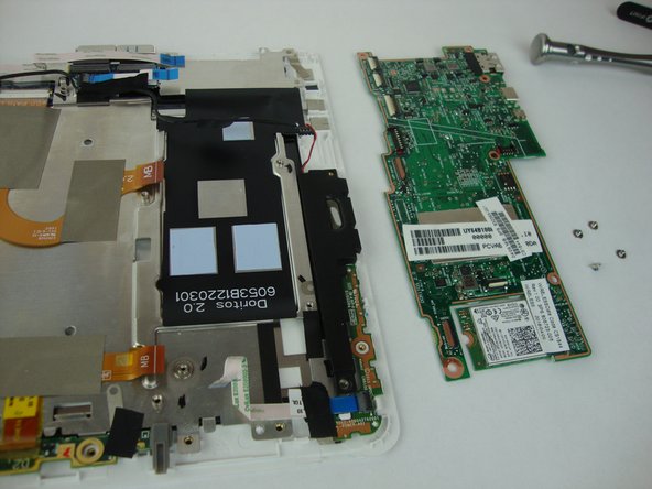

  6. HP Pavilion x2 10-n113dx  Mainboard Replacement, Mainboard: crwdns2935265:06crwdnd2935265:01crwdnd2935265:03crwdne2935265:0 HP Pavilion x2 10-n113dx  Mainboard Replacement, Mainboard: crwdns2935265:06crwdnd2935265:02crwdnd2935265:03crwdne2935265:0 HP Pavilion x2 10-n113dx  Mainboard Replacement, Mainboard: crwdns2935265:06crwdnd2935265:03crwdnd2935265:03crwdne2935265:0
    • To unscrew the mainboard use the Phillips #0 Screwdriver to remove two types of screws. Three 4.15mm head, 2.35mm in length screws and three 3.32mm head, 3.99mm in length screws
  7. HP Pavilion x2 10-n113dx  Mainboard Replacement: crwdns2935265:07crwdnd2935265:01crwdnd2935265:03crwdne2935265:0 HP Pavilion x2 10-n113dx  Mainboard Replacement: crwdns2935265:07crwdnd2935265:02crwdnd2935265:03crwdne2935265:0 HP Pavilion x2 10-n113dx  Mainboard Replacement: crwdns2935265:07crwdnd2935265:03crwdnd2935265:03crwdne2935265:0
    • Remove mainboard.
