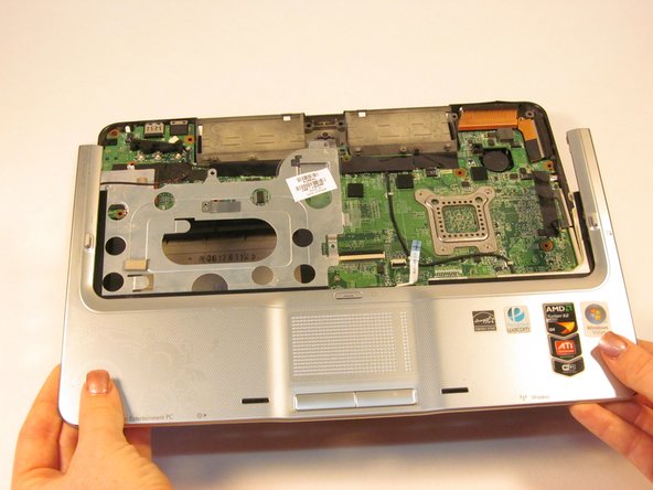

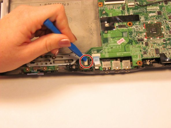

    • Disconnect the wire from the system board using the plastic opening tool.
    • Disconnect the wire from the optical drive using the plastic opening tool.
    • Gently lift the top cover from the tablet.

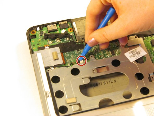

    • Using the plastic opening tool, disconnect the plastic blue film from the tablet.
    • Disconnect the wire using the plastic opening tool.

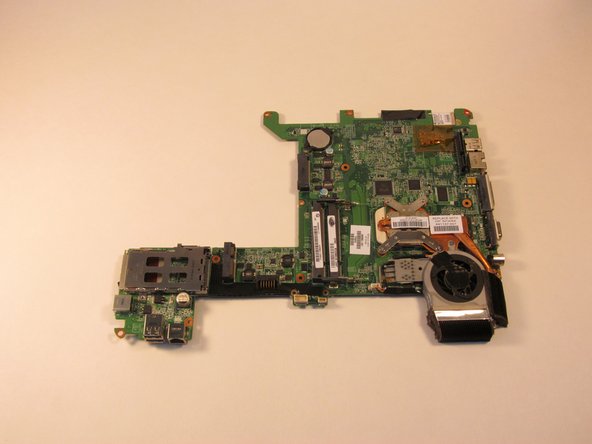

    • Lift the system board from the tablet.
    • Turn the system board over and lay it flat on a soft surface.
  16. HP Pavilion tx2500 Fan  Replacement: crwdns2935265:016crwdnd2935265:01crwdnd2935265:02crwdne2935265:0 HP Pavilion tx2500 Fan  Replacement: crwdns2935265:016crwdnd2935265:02crwdnd2935265:02crwdne2935265:0

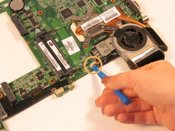

    • Using a Phillips #00, remove the 4.5 mm screws that connect the fan to the board.
    • Using a plastic opening tool, disconnect the wire that attached the fan to the board.
  17. HP Pavilion tx2500 Fan  Replacement: crwdns2935265:017crwdnd2935265:01crwdnd2935265:01crwdne2935265:0
    • Gently lift the fan away from the board.
