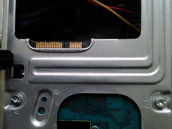

  3. HP Pavilion p6 Hard Drive Replacement: crwdns2935265:03crwdnd2935265:01crwdnd2935265:03crwdne2935265:0 HP Pavilion p6 Hard Drive Replacement: crwdns2935265:03crwdnd2935265:02crwdnd2935265:03crwdne2935265:0 HP Pavilion p6 Hard Drive Replacement: crwdns2935265:03crwdnd2935265:03crwdnd2935265:03crwdne2935265:0
    • Firstly the power and Sata cables should be disconected - they can be removed by just pulling them straight back.
    • After this is done it should look like the second picture.
    • Lastly four screws need to be removed that secure the Hard Drive to the case.
    • Extreme care should be take here as the Hard Drive should be supported when loosening off the last screw. Be careful not to press on the casing and only hold it by the edges.
  4. HP Pavilion p6 Hard Drive Replacement: crwdns2935265:04crwdnd2935265:01crwdnd2935265:03crwdne2935265:0 HP Pavilion p6 Hard Drive Replacement: crwdns2935265:04crwdnd2935265:02crwdnd2935265:03crwdne2935265:0 HP Pavilion p6 Hard Drive Replacement: crwdns2935265:04crwdnd2935265:03crwdnd2935265:03crwdne2935265:0
    • The computer should now look like the first picture.
    • While still supporting the Hard Drive by the edges slowly pull it towards you as shown and out of the computer.
    • Make sure you keep it in a safe place and don't apply any force to the top cover.
