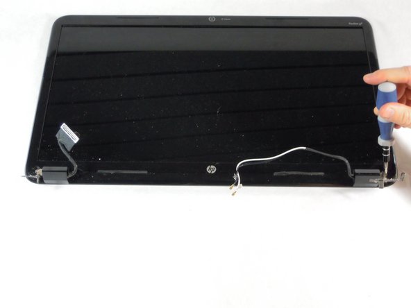

    • Unscrew the four black 7 mm Phillips #1 screws that attach the hinges to the case.
    • Remove the screen assembly from the laptop.

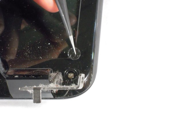

    • Using tweezers, remove the two screw covers at the bottom of the screen.
    • Unscrew the two 6 mm Phillips #1 screws from the bottom of the screen.

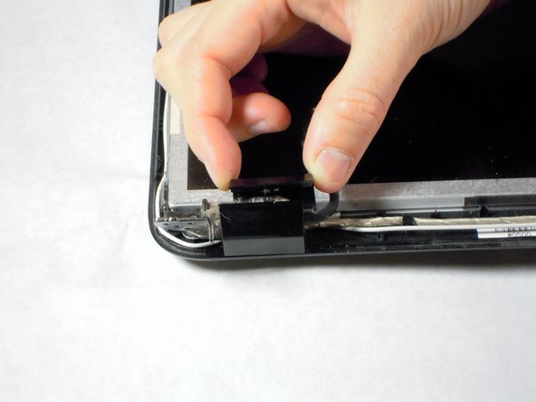

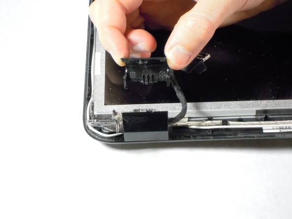

    • Unscrew the six 5 mm Phillips #1 screws.
    • Remove the two black hinge covers.

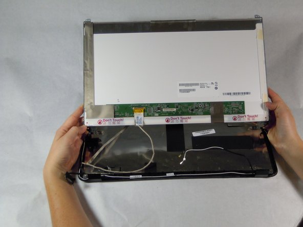

    • Be careful when moving the screen, you may damage the monitor and webcam cable.
    • Gently remove the screen from its housing. Turn the screen over (parallel to you) and disconnect the webcam cable.
    • Separate the webcam cable from the screen.
