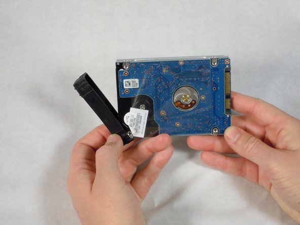

  8. HP Pavilion g7-2275dx Hard Drive Replacement: crwdns2935265:08crwdnd2935265:01crwdnd2935265:01crwdne2935265:0
    • Remove the plastic cover from the hard drive.
To reassemble or replace your hard drive, follow these instructions in reverse order with the working drive.
