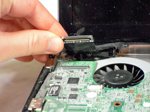

  25. HP Pavilion g7-2275dx Fan Replacement: crwdns2935265:025crwdnd2935265:01crwdnd2935265:03crwdne2935265:0 HP Pavilion g7-2275dx Fan Replacement: crwdns2935265:025crwdnd2935265:02crwdnd2935265:03crwdne2935265:0 HP Pavilion g7-2275dx Fan Replacement: crwdns2935265:025crwdnd2935265:03crwdnd2935265:03crwdne2935265:0
    • Lift, with your fingers or a plastic opening tool, the large black monitor cable at the top of the left hand corner of the motherboard.
