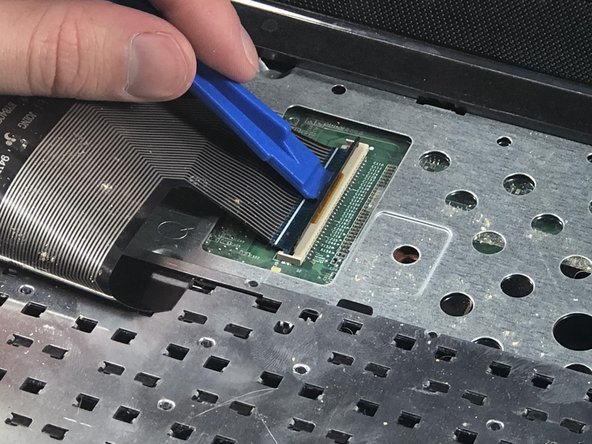

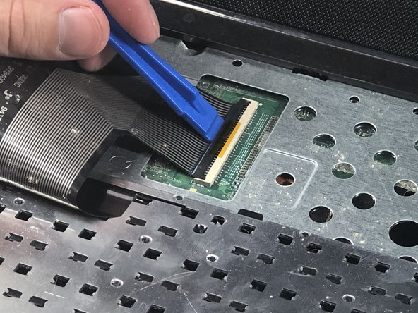

    • Locate the keyboard cable connector.
    • Using a plastic opening tool, flip up the locking tab on the Zero Insertion Force (ZIF) connector.

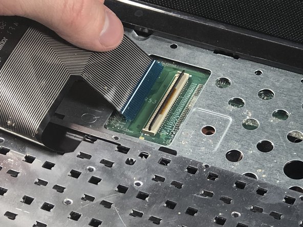

  18. HP Pavilion g7-2023cl Upper Case Assembly Replacement: crwdns2935265:018crwdnd2935265:01crwdnd2935265:02crwdne2935265:0 HP Pavilion g7-2023cl Upper Case Assembly Replacement: crwdns2935265:018crwdnd2935265:02crwdnd2935265:02crwdne2935265:0
    • Pull the keyboard ribbon cable out from the connector.

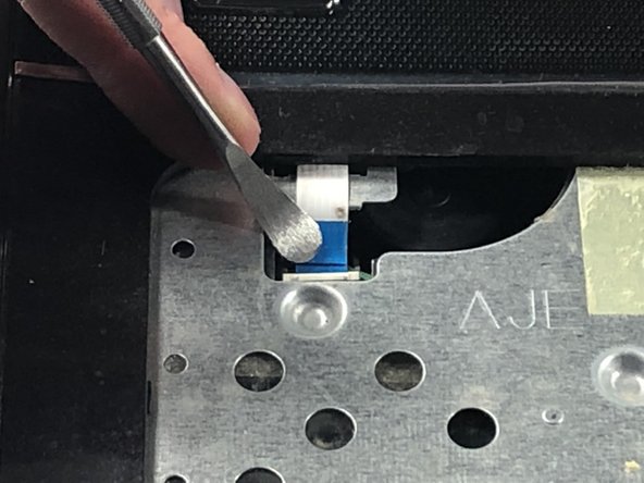

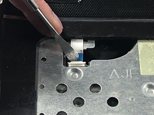

    • Locate the power button cable near the top left corner of the upper case assembly.
    • Using a spudger, flip up the power button ribbon cable locking tab.

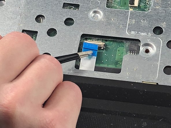

    • Locate the track pad cable near the track pad.
  24. HP Pavilion g7-2023cl Upper Case Assembly Replacement: crwdns2935265:024crwdnd2935265:01crwdnd2935265:02crwdne2935265:0 HP Pavilion g7-2023cl Upper Case Assembly Replacement: crwdns2935265:024crwdnd2935265:02crwdnd2935265:02crwdne2935265:0
    • Using tweezers, pull the trackpad ribbon cable out from the connector on the motherboard.
