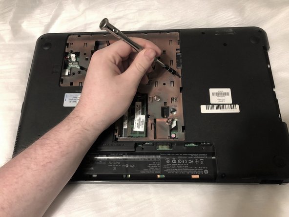

  3. HP Pavilion g7-2023cl Optical Drive Replacement, Service Door: crwdns2935265:03crwdnd2935265:01crwdnd2935265:02crwdne2935265:0 HP Pavilion g7-2023cl Optical Drive Replacement, Service Door: crwdns2935265:03crwdnd2935265:02crwdnd2935265:02crwdne2935265:0
    • Using a Phillips #0 screwdriver, loosen the service door screw.
    • This is a captive screw that will remain attached to the service door.

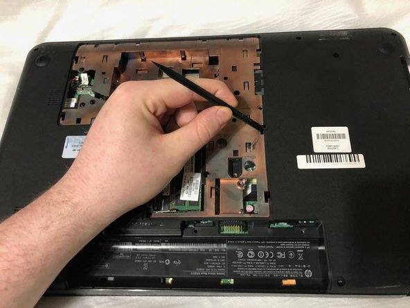

  4. HP Pavilion g7-2023cl Optical Drive Replacement: crwdns2935265:04crwdnd2935265:01crwdnd2935265:02crwdne2935265:0 HP Pavilion g7-2023cl Optical Drive Replacement: crwdns2935265:04crwdnd2935265:02crwdnd2935265:02crwdne2935265:0
    • Lift the service door up and away from the device.

    • Using a Phillips #0 screwdriver, remove the optical drive anchor screw.

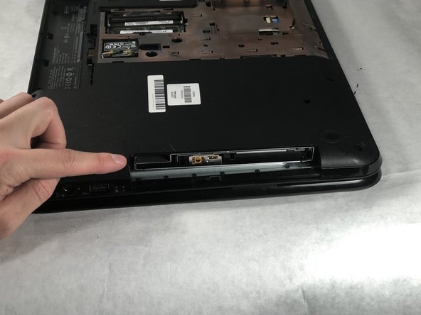

  6. HP Pavilion g7-2023cl Optical Drive Replacement: crwdns2935265:06crwdnd2935265:01crwdnd2935265:02crwdne2935265:0 HP Pavilion g7-2023cl Optical Drive Replacement: crwdns2935265:06crwdnd2935265:02crwdnd2935265:02crwdne2935265:0
    • Insert the flat end of a spudger into the optical drive release access hole.

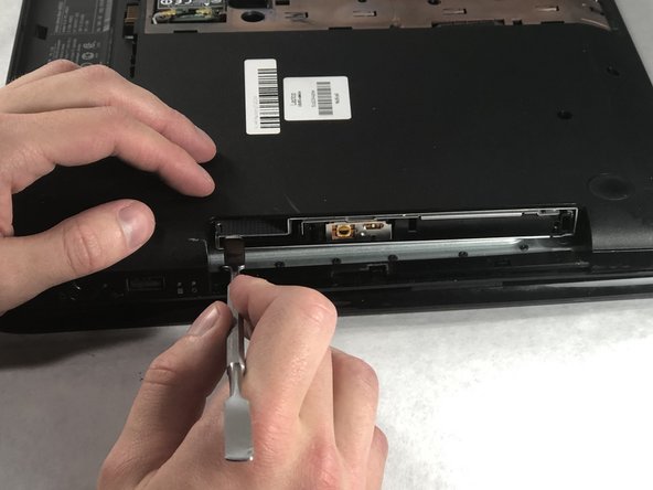

  7. HP Pavilion g7-2023cl Optical Drive Replacement: crwdns2935265:07crwdnd2935265:01crwdnd2935265:03crwdne2935265:0 HP Pavilion g7-2023cl Optical Drive Replacement: crwdns2935265:07crwdnd2935265:02crwdnd2935265:03crwdne2935265:0 HP Pavilion g7-2023cl Optical Drive Replacement: crwdns2935265:07crwdnd2935265:03crwdnd2935265:03crwdne2935265:0
    • Orient the device so that you can remove the optical drive.
    • If you are missing the bezel (face of the optical drive) or have the bezel these same steps work to remove the optical drive.
    • Using a spudger, slide out the optical drive enough so that you can grab it with your hand.

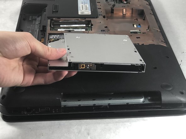

  8. HP Pavilion g7-2023cl Optical Drive Replacement: crwdns2935265:08crwdnd2935265:01crwdnd2935265:02crwdne2935265:0 HP Pavilion g7-2023cl Optical Drive Replacement: crwdns2935265:08crwdnd2935265:02crwdnd2935265:02crwdne2935265:0
    • Remove the optical drive by pulling it out of the device.
    • When replacing the optical drive, slide it completely back into the slot so that it fits flush.
