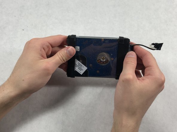

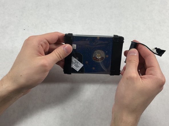

    • Locate the hard drive cable.
    • Disconnect the hard drive cable.

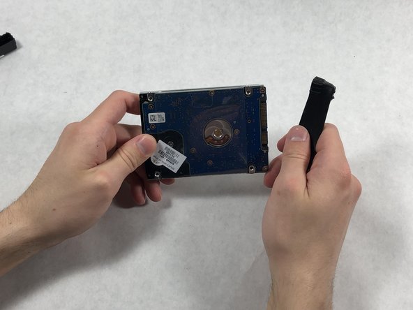

  9. HP Pavilion g7-2023cl Hard Drive Mounting Bracket Replacement: crwdns2935265:09crwdnd2935265:01crwdnd2935265:03crwdne2935265:0 HP Pavilion g7-2023cl Hard Drive Mounting Bracket Replacement: crwdns2935265:09crwdnd2935265:02crwdnd2935265:03crwdne2935265:0 HP Pavilion g7-2023cl Hard Drive Mounting Bracket Replacement: crwdns2935265:09crwdnd2935265:03crwdnd2935265:03crwdne2935265:0

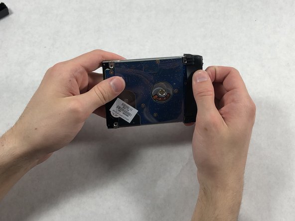

    • Remove the bumper by simply pulling it off with your fingers.

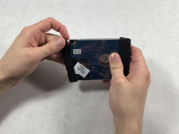

  10. HP Pavilion g7-2023cl Hard Drive Mounting Bracket Replacement: crwdns2935265:010crwdnd2935265:01crwdnd2935265:02crwdne2935265:0 HP Pavilion g7-2023cl Hard Drive Mounting Bracket Replacement: crwdns2935265:010crwdnd2935265:02crwdnd2935265:02crwdne2935265:0
    • Remove the other bumper the same way as the last one.

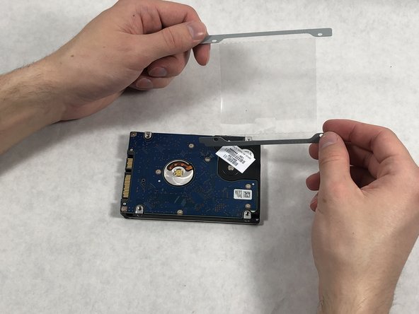

    • Using a Phillips #0 screwdriver, remove the four Phillips M3.0×3.5 screws (two on either side of the hard drive).
  12. HP Pavilion g7-2023cl Hard Drive Mounting Bracket Replacement: crwdns2935265:012crwdnd2935265:01crwdnd2935265:02crwdne2935265:0 HP Pavilion g7-2023cl Hard Drive Mounting Bracket Replacement: crwdns2935265:012crwdnd2935265:02crwdnd2935265:02crwdne2935265:0
    • Remove the mounting bracket.
