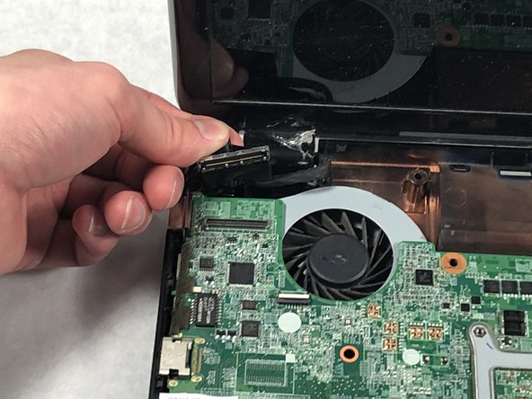

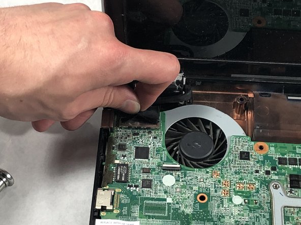

  28. HP Pavilion g7-2023cl Display Assembly Replacement, Display Assembly: crwdns2935265:028crwdnd2935265:01crwdnd2935265:03crwdne2935265:0 HP Pavilion g7-2023cl Display Assembly Replacement, Display Assembly: crwdns2935265:028crwdnd2935265:02crwdnd2935265:03crwdne2935265:0 HP Pavilion g7-2023cl Display Assembly Replacement, Display Assembly: crwdns2935265:028crwdnd2935265:03crwdnd2935265:03crwdne2935265:0
    • Locate the display panel cable.
    • Disconnect the display panel cable.

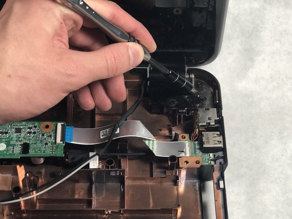

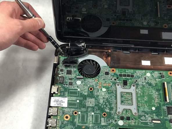

  29. HP Pavilion g7-2023cl Display Assembly Replacement: crwdns2935265:029crwdnd2935265:01crwdnd2935265:03crwdne2935265:0 HP Pavilion g7-2023cl Display Assembly Replacement: crwdns2935265:029crwdnd2935265:02crwdnd2935265:03crwdne2935265:0 HP Pavilion g7-2023cl Display Assembly Replacement: crwdns2935265:029crwdnd2935265:03crwdnd2935265:03crwdne2935265:0
    • Using a Phillips #0 screwdriver, remove all six screws securing the display assembly hinges to the laptop.

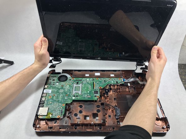

  30. HP Pavilion g7-2023cl Display Assembly Replacement: crwdns2935265:030crwdnd2935265:01crwdnd2935265:02crwdne2935265:0 HP Pavilion g7-2023cl Display Assembly Replacement: crwdns2935265:030crwdnd2935265:02crwdnd2935265:02crwdne2935265:0
    • Lift up and remove the display assembly from the laptop.
