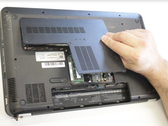

    • Turn the device over so that the lower case is facing up.
    • Slide the battery release latch. The battery will pop up.
  2. HP Pavilion g7-1368dx Keyboard Replacement: crwdns2935265:02crwdnd2935265:01crwdnd2935265:01crwdne2935265:0
    • Lift and remove the battery from its compartment.
  3. HP Pavilion g7-1368dx Keyboard Replacement, Keyboard: crwdns2935265:03crwdnd2935265:01crwdnd2935265:03crwdne2935265:0 HP Pavilion g7-1368dx Keyboard Replacement, Keyboard: crwdns2935265:03crwdnd2935265:02crwdnd2935265:03crwdne2935265:0 HP Pavilion g7-1368dx Keyboard Replacement, Keyboard: crwdns2935265:03crwdnd2935265:03crwdnd2935265:03crwdne2935265:0
    • Loosen the two Phillips #1 screws that connect the service panel to the device.
    • These are captive screws and cannot be fully removed. They will remain attached to the service panel.
    • Slide the service panel down and pull it up to remove.

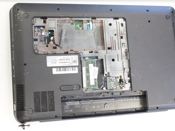

  4. HP Pavilion g7-1368dx Keyboard Replacement: crwdns2935265:04crwdnd2935265:01crwdnd2935265:01crwdne2935265:0
    • Remove the one 7 mm Phillips #1 screw securing the keyboard to the device.

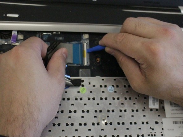

    • Flip over the device and open the screen.
  6. HP Pavilion g7-1368dx Keyboard Replacement: crwdns2935265:06crwdnd2935265:01crwdnd2935265:02crwdne2935265:0 HP Pavilion g7-1368dx Keyboard Replacement: crwdns2935265:06crwdnd2935265:02crwdnd2935265:02crwdne2935265:0
    • Flip the keyboard over and locate the black ribbon cable that attaches the keyboard to the device.
    • Using a plastic opening tool, flip up the white tab on the zero insertion force connector.
    • Disconnect the ribbon cable by sliding it out of the ZIF connector.
    • Remove the keyboard.
