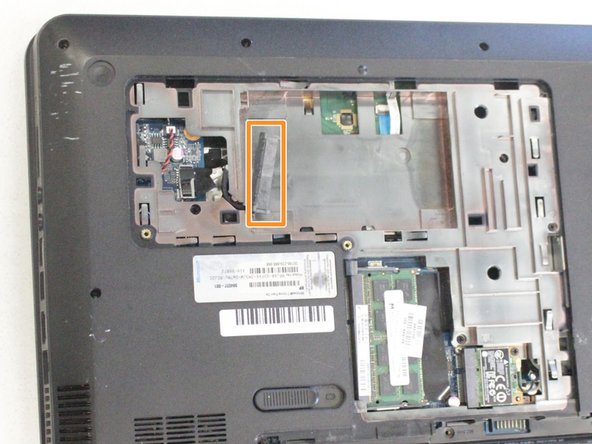

  3. HP Pavilion g7-1368dx  Hard Drive Replacement, Hard Drive: crwdns2935265:03crwdnd2935265:01crwdnd2935265:01crwdne2935265:0
    • Loosen the two Phillips #1 screws that connect the service panel to the device.
    • These are captive screws and cannot be fully removed. They will remain attached to the service panel.
  4. HP Pavilion g7-1368dx  Hard Drive Replacement: crwdns2935265:04crwdnd2935265:01crwdnd2935265:01crwdne2935265:0
    • Slide the service panel down and pull it up to remove.
  5. HP Pavilion g7-1368dx  Hard Drive Replacement: crwdns2935265:05crwdnd2935265:01crwdnd2935265:02crwdne2935265:0 HP Pavilion g7-1368dx  Hard Drive Replacement: crwdns2935265:05crwdnd2935265:02crwdnd2935265:02crwdne2935265:0
    • Locate the hard drive.
    • It is missing from the device pictured here.
    • Disconnect the cable connector by pulling it away from the hard drive.
    • Remove the hard drive from the device.
