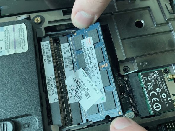

  4. HP Pavilion g7-1365dx RAM Replacement, RAM: crwdns2935265:04crwdnd2935265:01crwdnd2935265:02crwdne2935265:0 HP Pavilion g7-1365dx RAM Replacement, RAM: crwdns2935265:04crwdnd2935265:02crwdnd2935265:02crwdne2935265:0
    • Use your fingers to simultaneously pull apart both tabs holding the module.
    • The memory module will pop up once the tabs are pulled so that it can be removed.
  5. HP Pavilion g7-1365dx RAM Replacement: crwdns2935265:05crwdnd2935265:01crwdnd2935265:01crwdne2935265:0
    • Directly pull out the memory module as shown.
