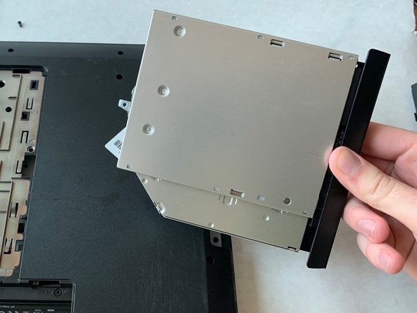

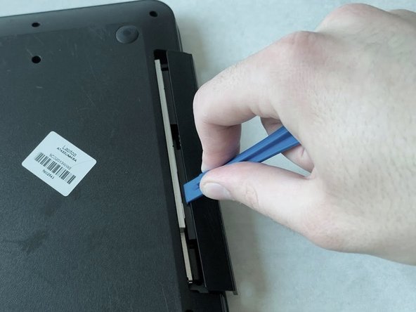

  4. HP Pavilion g7-1365dx Optical Drive Replacement, Optical Drive: crwdns2935265:04crwdnd2935265:01crwdnd2935265:03crwdne2935265:0 HP Pavilion g7-1365dx Optical Drive Replacement, Optical Drive: crwdns2935265:04crwdnd2935265:02crwdnd2935265:03crwdne2935265:0 HP Pavilion g7-1365dx Optical Drive Replacement, Optical Drive: crwdns2935265:04crwdnd2935265:03crwdnd2935265:03crwdne2935265:0
    • Using the Phillips size 00 screwdriver, unscrew the 4.7 mm screw that holds the optical drive.
    • Use the opening tool to slide the drive out the side of the laptop to remove it.
