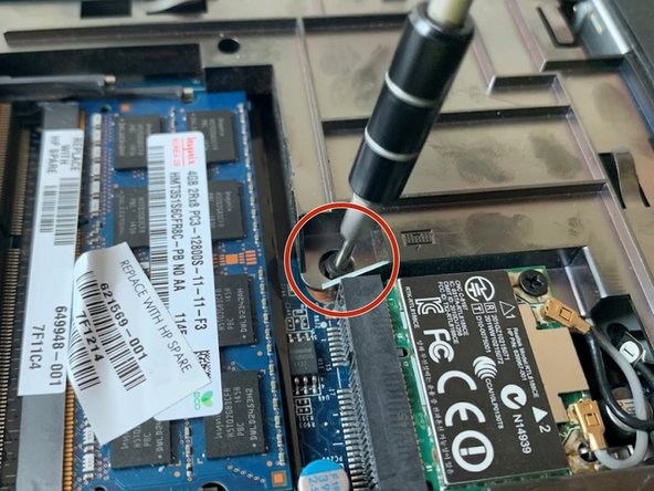

  4. HP Pavilion g7-1365dx Keyboard Replacement, Keyboard: crwdns2935265:04crwdnd2935265:01crwdnd2935265:02crwdne2935265:0 HP Pavilion g7-1365dx Keyboard Replacement, Keyboard: crwdns2935265:04crwdnd2935265:02crwdnd2935265:02crwdne2935265:0
    • Remove the 4.7 mm screw that secures the keyboard to the computer using the Philips 00 screwdriver.
