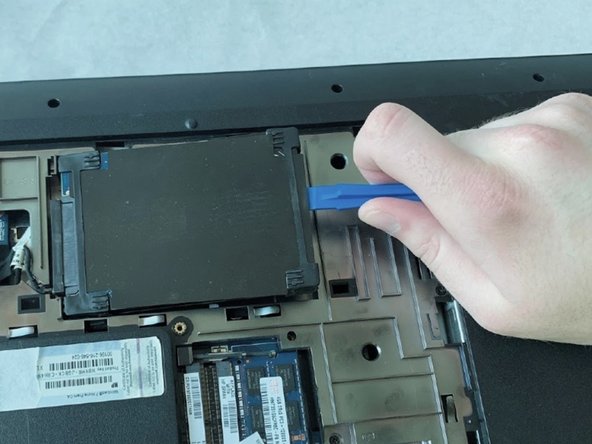

  4. HP Pavilion g7-1365dx Hard Drive Replacement, Hard Drive: crwdns2935265:04crwdnd2935265:01crwdnd2935265:03crwdne2935265:0 HP Pavilion g7-1365dx Hard Drive Replacement, Hard Drive: crwdns2935265:04crwdnd2935265:02crwdnd2935265:03crwdne2935265:0 HP Pavilion g7-1365dx Hard Drive Replacement, Hard Drive: crwdns2935265:04crwdnd2935265:03crwdnd2935265:03crwdne2935265:0
    • Disconnect the drive connector cable from the system board by pulling the plastic tab on top of the connector.
    • Use the opening tool to lift the hard drive out.
    • Remove the hard drive.
