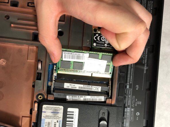

  6. HP Pavilion g7-1150us RAM Replacement, RAM: crwdns2935265:06crwdnd2935265:01crwdnd2935265:01crwdne2935265:0
    • Push outwards on the two clips holding the RAM in place.
  7. HP Pavilion g7-1150us RAM Replacement: crwdns2935265:07crwdnd2935265:01crwdnd2935265:02crwdne2935265:0 HP Pavilion g7-1150us RAM Replacement: crwdns2935265:07crwdnd2935265:02crwdnd2935265:02crwdne2935265:0
    • Slide the RAM out of its position in the opposite direction of the battery removal switch.
