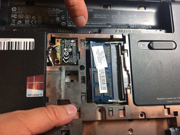

  6. HP Pavilion g6-2228tx RAM Replacement, RAM: crwdns2935265:06crwdnd2935265:01crwdnd2935265:02crwdne2935265:0 HP Pavilion g6-2228tx RAM Replacement, RAM: crwdns2935265:06crwdnd2935265:02crwdnd2935265:02crwdne2935265:0
    • The silver hinges holds the RAM in place.

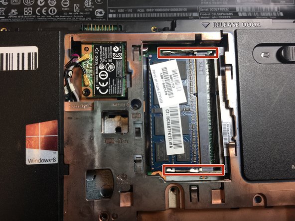

  7. HP Pavilion g6-2228tx RAM Replacement: crwdns2935265:07crwdnd2935265:01crwdnd2935265:02crwdne2935265:0 HP Pavilion g6-2228tx RAM Replacement: crwdns2935265:07crwdnd2935265:02crwdnd2935265:02crwdne2935265:0
    • Use two fingers to push both silver hinges outward to release the RAM.
    • The released RAM will pop up.
  8. HP Pavilion g6-2228tx RAM Replacement: crwdns2935265:08crwdnd2935265:01crwdnd2935265:01crwdne2935265:0
    • Pull the RAM stick to the left and remove it from the device.
