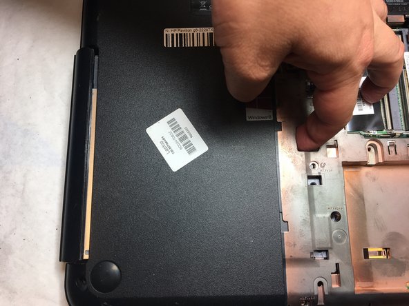

  3. HP Pavilion g6-2228tx Optical Drive Replacement: crwdns2935265:03crwdnd2935265:01crwdnd2935265:03crwdne2935265:0 HP Pavilion g6-2228tx Optical Drive Replacement: crwdns2935265:03crwdnd2935265:02crwdnd2935265:03crwdne2935265:0 HP Pavilion g6-2228tx Optical Drive Replacement: crwdns2935265:03crwdnd2935265:03crwdnd2935265:03crwdne2935265:0
    • Place your hand on the cover and slide the cover down.
    • Use your hand to lift the cover from the bottom right and slide the cover to the right to remove the cover.

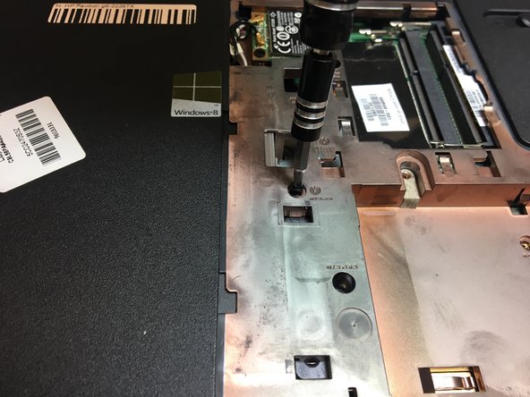

  6. HP Pavilion g6-2228tx Optical Drive Replacement, Optical Drive: crwdns2935265:06crwdnd2935265:01crwdnd2935265:02crwdne2935265:0 HP Pavilion g6-2228tx Optical Drive Replacement, Optical Drive: crwdns2935265:06crwdnd2935265:02crwdnd2935265:02crwdne2935265:0
    • Remove the 2.5mm screw with a Phillips #0 screw drive.

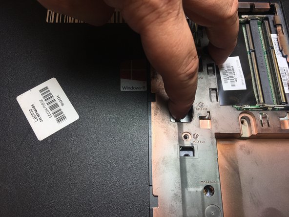

  7. HP Pavilion g6-2228tx Optical Drive Replacement: crwdns2935265:07crwdnd2935265:01crwdnd2935265:03crwdne2935265:0 HP Pavilion g6-2228tx Optical Drive Replacement: crwdns2935265:07crwdnd2935265:02crwdnd2935265:03crwdne2935265:0 HP Pavilion g6-2228tx Optical Drive Replacement: crwdns2935265:07crwdnd2935265:03crwdnd2935265:03crwdne2935265:0
    • Put one finger into the release hole and push to the left until part of the optical drive comes out from the left of the laptop.

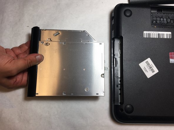

  8. HP Pavilion g6-2228tx Optical Drive Replacement: crwdns2935265:08crwdnd2935265:01crwdnd2935265:03crwdne2935265:0 HP Pavilion g6-2228tx Optical Drive Replacement: crwdns2935265:08crwdnd2935265:02crwdnd2935265:03crwdne2935265:0 HP Pavilion g6-2228tx Optical Drive Replacement: crwdns2935265:08crwdnd2935265:03crwdnd2935265:03crwdne2935265:0
    • Grab the optical drive and pull to the left to remove it from the device.
