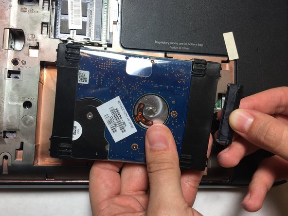

  4. HP Pavilion g6-2228tx Hard Drive Replacement: crwdns2935265:04crwdnd2935265:01crwdnd2935265:02crwdne2935265:0 HP Pavilion g6-2228tx Hard Drive Replacement: crwdns2935265:04crwdnd2935265:02crwdnd2935265:02crwdne2935265:0
    • Place one finger on the right side of the hard drive.
    • Push the hard drive to the left and lift the hard drive up to remove it from the device.
  5. HP Pavilion g6-2228tx Hard Drive Replacement: crwdns2935265:05crwdnd2935265:01crwdnd2935265:02crwdne2935265:0 HP Pavilion g6-2228tx Hard Drive Replacement: crwdns2935265:05crwdnd2935265:02crwdnd2935265:02crwdne2935265:0
    • Disconnect the connecting part by pulling the part to the right.
    • Remove the hard drive from the device.
