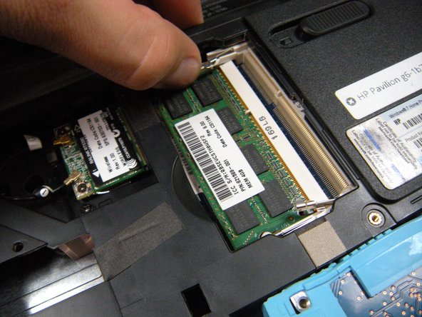

  7. HP Pavilion g6-1b79dx Speaker Replacement, RAM: crwdns2935265:07crwdnd2935265:01crwdnd2935265:03crwdne2935265:0 HP Pavilion g6-1b79dx Speaker Replacement, RAM: crwdns2935265:07crwdnd2935265:02crwdnd2935265:03crwdne2935265:0 HP Pavilion g6-1b79dx Speaker Replacement, RAM: crwdns2935265:07crwdnd2935265:03crwdnd2935265:03crwdne2935265:0
    • Slide the two latches away from the RAM to unhook it.
  8. HP Pavilion g6-1b79dx Speaker Replacement: crwdns2935265:08crwdnd2935265:01crwdnd2935265:03crwdne2935265:0 HP Pavilion g6-1b79dx Speaker Replacement: crwdns2935265:08crwdnd2935265:02crwdnd2935265:03crwdne2935265:0 HP Pavilion g6-1b79dx Speaker Replacement: crwdns2935265:08crwdnd2935265:03crwdnd2935265:03crwdne2935265:0
    • Gently slide the RAM out from the laptop.

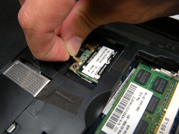

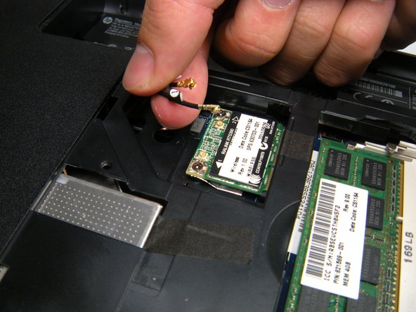

  11. HP Pavilion g6-1b79dx Speaker Replacement, Wireless Card: crwdns2935265:011crwdnd2935265:01crwdnd2935265:03crwdne2935265:0 HP Pavilion g6-1b79dx Speaker Replacement, Wireless Card: crwdns2935265:011crwdnd2935265:02crwdnd2935265:03crwdne2935265:0 HP Pavilion g6-1b79dx Speaker Replacement, Wireless Card: crwdns2935265:011crwdnd2935265:03crwdnd2935265:03crwdne2935265:0
    • Unlatch the two antenna cable connectors from the wireless card.
  12. HP Pavilion g6-1b79dx Speaker Replacement: crwdns2935265:012crwdnd2935265:01crwdnd2935265:01crwdne2935265:0
    • Remove the two 2.5 mm screws in the wireless card with a PH00 screwdriver.
    • You may have to gently bend the cables away from the wireless card to remove the screws
  13. HP Pavilion g6-1b79dx Speaker Replacement: crwdns2935265:013crwdnd2935265:01crwdnd2935265:03crwdne2935265:0 HP Pavilion g6-1b79dx Speaker Replacement: crwdns2935265:013crwdnd2935265:02crwdnd2935265:03crwdne2935265:0 HP Pavilion g6-1b79dx Speaker Replacement: crwdns2935265:013crwdnd2935265:03crwdnd2935265:03crwdne2935265:0
    • Gently disconnect the wireless card from the laptop.

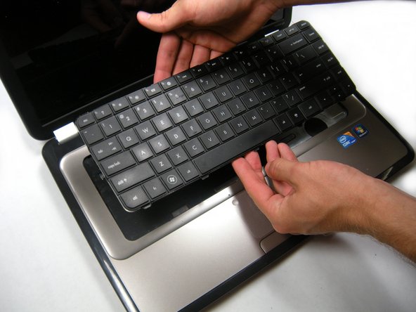

  17. HP Pavilion g6-1b79dx Speaker Replacement: crwdns2935265:017crwdnd2935265:01crwdnd2935265:01crwdne2935265:0
    • Flip the laptop over and open it.
    • The components beneath your computer may be loose and fall out when you flip the laptop. Be careful when turning it over.
  18. HP Pavilion g6-1b79dx Speaker Replacement: crwdns2935265:018crwdnd2935265:01crwdnd2935265:03crwdne2935265:0 HP Pavilion g6-1b79dx Speaker Replacement: crwdns2935265:018crwdnd2935265:02crwdnd2935265:03crwdne2935265:0 HP Pavilion g6-1b79dx Speaker Replacement: crwdns2935265:018crwdnd2935265:03crwdnd2935265:03crwdne2935265:0
    • Insert a plastic spudger or similar pry tool, beneath the keyboard, near the "insert" key, and pop the keyboard up from the laptop.
    • When working with electronics, it's important to choose a tool that's ESD-safe to avoid accidental damage to the device. The regular black nylon spudger or a plastic opening tool should be used whenever possible.
    • Starting at the opening you just created, run your fingers around the outside of the keyboard separating it from the rest of the computer.
    • Only lift the keyboard up a few inches because it is attached to the laptop by a ribbon cable.

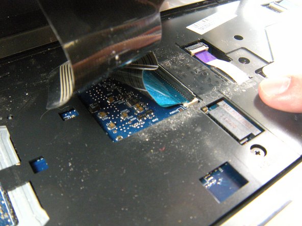

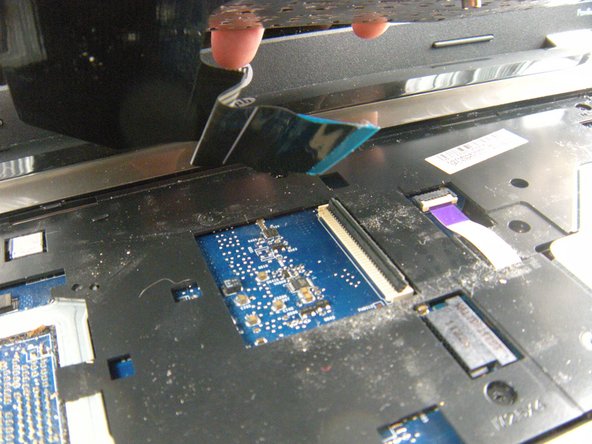

  19. HP Pavilion g6-1b79dx Speaker Replacement: crwdns2935265:019crwdnd2935265:01crwdnd2935265:03crwdne2935265:0 HP Pavilion g6-1b79dx Speaker Replacement: crwdns2935265:019crwdnd2935265:02crwdnd2935265:03crwdne2935265:0 HP Pavilion g6-1b79dx Speaker Replacement: crwdns2935265:019crwdnd2935265:03crwdnd2935265:03crwdne2935265:0
    • Slightly angle the keyboard back so the ribbon connector underneath it is visible.
    • Remove the ribbon cable by using your fingers to pull up and away from the connector.
  20. HP Pavilion g6-1b79dx Speaker Replacement: crwdns2935265:020crwdnd2935265:01crwdnd2935265:01crwdne2935265:0
    • With the ribbon cable detached, you can now completely remove the keyboard.

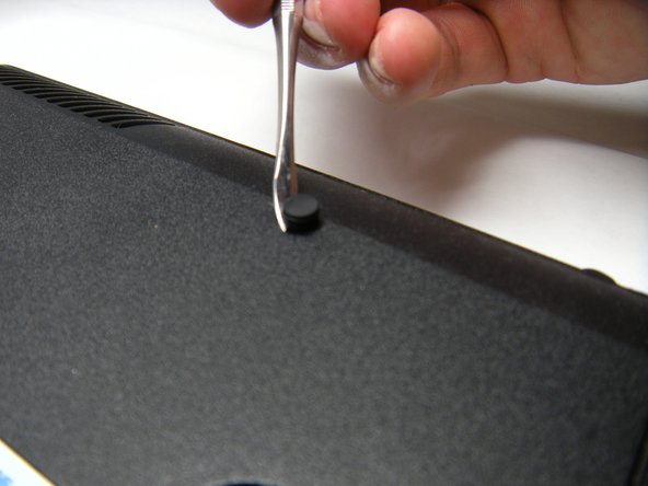

  21. HP Pavilion g6-1b79dx Speaker Replacement, Speaker: crwdns2935265:021crwdnd2935265:01crwdnd2935265:03crwdne2935265:0 HP Pavilion g6-1b79dx Speaker Replacement, Speaker: crwdns2935265:021crwdnd2935265:02crwdnd2935265:03crwdne2935265:0 HP Pavilion g6-1b79dx Speaker Replacement, Speaker: crwdns2935265:021crwdnd2935265:03crwdnd2935265:03crwdne2935265:0
    • With the laptop bottom facing up, locate the rubber plug on the right side of the computer.
    • Use a metal splunger to remove the plug.

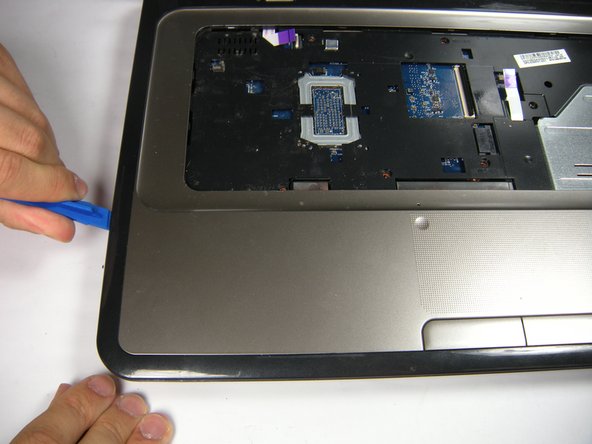

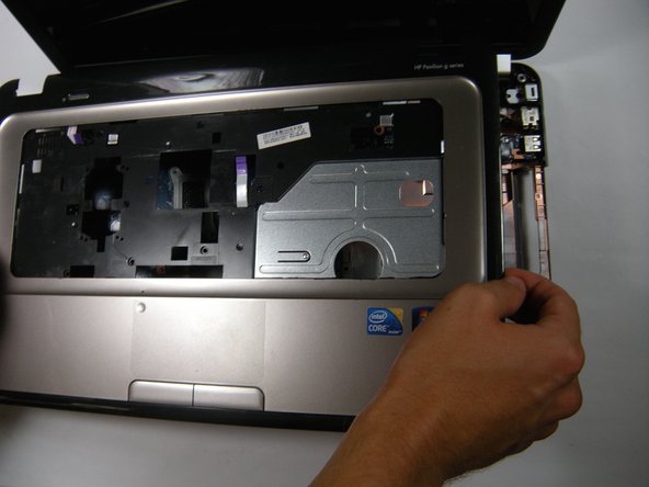

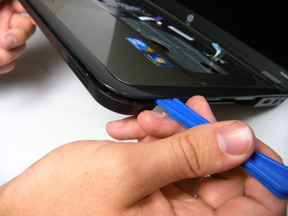

  24. HP Pavilion g6-1b79dx Speaker Replacement: crwdns2935265:024crwdnd2935265:01crwdnd2935265:03crwdne2935265:0 HP Pavilion g6-1b79dx Speaker Replacement: crwdns2935265:024crwdnd2935265:02crwdnd2935265:03crwdne2935265:0 HP Pavilion g6-1b79dx Speaker Replacement: crwdns2935265:024crwdnd2935265:03crwdnd2935265:03crwdne2935265:0
    • Use the plastic opening tool to pry out the front panel around the entire computer.
  25. HP Pavilion g6-1b79dx Speaker Replacement: crwdns2935265:025crwdnd2935265:01crwdnd2935265:03crwdne2935265:0 HP Pavilion g6-1b79dx Speaker Replacement: crwdns2935265:025crwdnd2935265:02crwdnd2935265:03crwdne2935265:0 HP Pavilion g6-1b79dx Speaker Replacement: crwdns2935265:025crwdnd2935265:03crwdnd2935265:03crwdne2935265:0
    • Gently lift the front panel away from the computer.

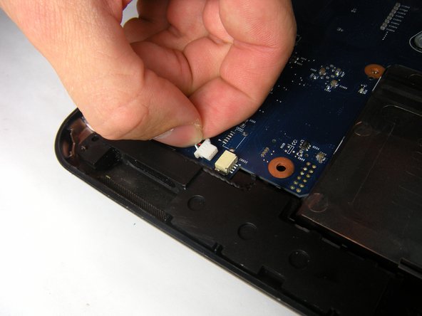

  26. HP Pavilion g6-1b79dx Speaker Replacement: crwdns2935265:026crwdnd2935265:01crwdnd2935265:03crwdne2935265:0 HP Pavilion g6-1b79dx Speaker Replacement: crwdns2935265:026crwdnd2935265:02crwdnd2935265:03crwdne2935265:0 HP Pavilion g6-1b79dx Speaker Replacement: crwdns2935265:026crwdnd2935265:03crwdnd2935265:03crwdne2935265:0

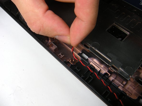

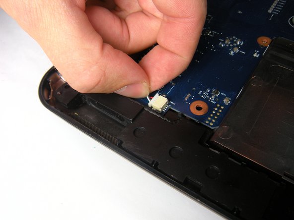

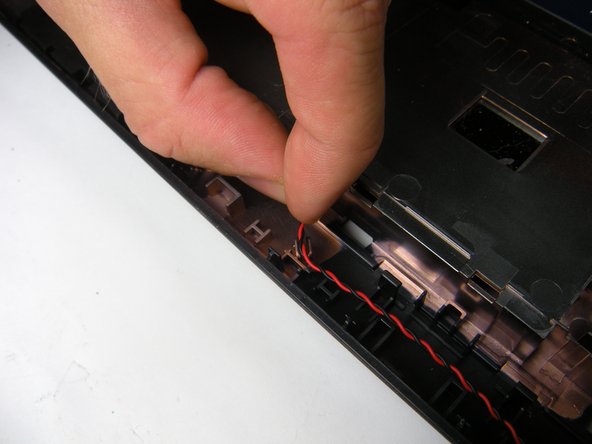

    • Locate the red and black speaker cables connecting the speakers and detach them from the two holders.
  27. HP Pavilion g6-1b79dx Speaker Replacement: crwdns2935265:027crwdnd2935265:01crwdnd2935265:03crwdne2935265:0 HP Pavilion g6-1b79dx Speaker Replacement: crwdns2935265:027crwdnd2935265:02crwdnd2935265:03crwdne2935265:0 HP Pavilion g6-1b79dx Speaker Replacement: crwdns2935265:027crwdnd2935265:03crwdnd2935265:03crwdne2935265:0
    • Pull the speaker cables out of their connectors.

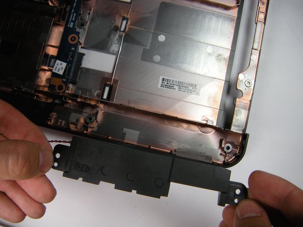

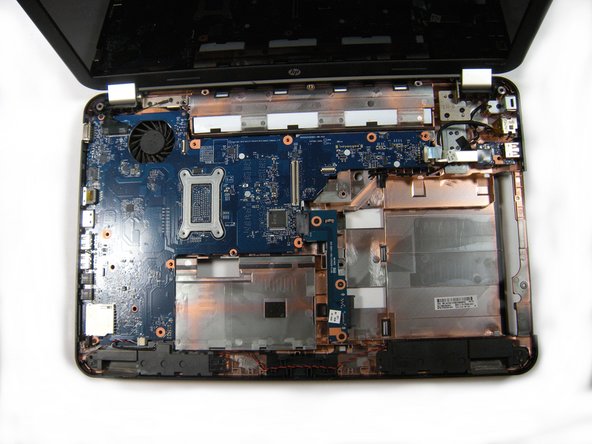

  28. HP Pavilion g6-1b79dx Speaker Replacement: crwdns2935265:028crwdnd2935265:01crwdnd2935265:02crwdne2935265:0 HP Pavilion g6-1b79dx Speaker Replacement: crwdns2935265:028crwdnd2935265:02crwdnd2935265:02crwdne2935265:0
    • Slide the left speaker out from under the blue motherboard.
  29. HP Pavilion g6-1b79dx Speaker Replacement: crwdns2935265:029crwdnd2935265:01crwdnd2935265:03crwdne2935265:0 HP Pavilion g6-1b79dx Speaker Replacement: crwdns2935265:029crwdnd2935265:02crwdnd2935265:03crwdne2935265:0 HP Pavilion g6-1b79dx Speaker Replacement: crwdns2935265:029crwdnd2935265:03crwdnd2935265:03crwdne2935265:0
    • Lift the right speaker directly up and remove it from the computer.
