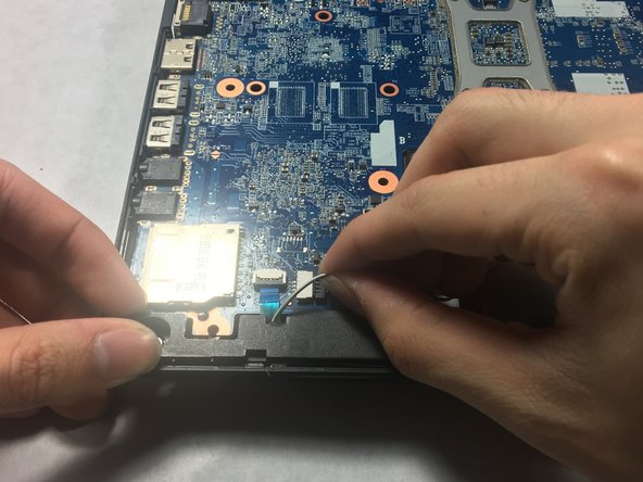

  10. HP Pavilion g4-1117dx Speaker Replacement, Speaker: crwdns2935265:011crwdnd2935265:01crwdnd2935265:02crwdne2935265:0 HP Pavilion g4-1117dx Speaker Replacement, Speaker: crwdns2935265:011crwdnd2935265:02crwdnd2935265:02crwdne2935265:0
    • Unplug the red and white wires.
  11. HP Pavilion g4-1117dx Speaker Replacement: crwdns2935265:012crwdnd2935265:01crwdnd2935265:01crwdne2935265:0
    • Remove the speakers.
