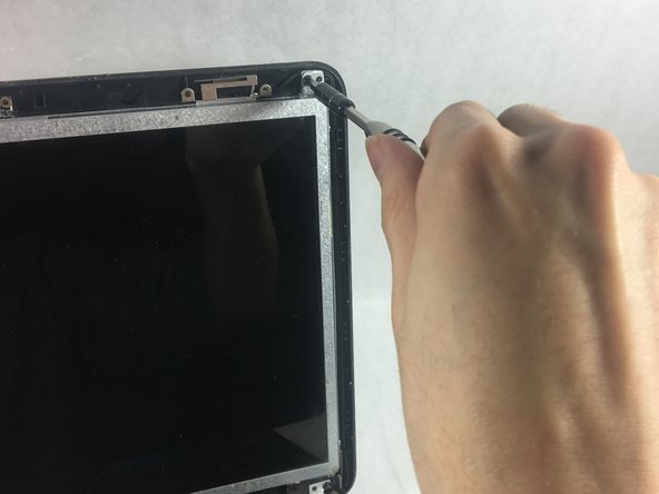

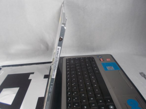

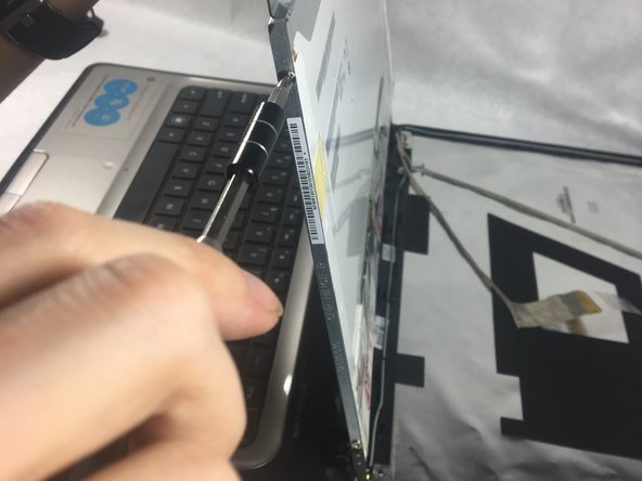

    • Remove two triangular shaped screw covers in the bottom corners of the monitor near the hinges.
    • Unscrew the two 4.0 mm JIS #0 screws holding the hinge covers.
  3. HP Pavilion g4-1117dx Screen Replacement: crwdns2935265:04crwdnd2935265:01crwdnd2935265:01crwdne2935265:0
    • Pry off the monitor border cover.
  4. HP Pavilion g4-1117dx Screen Replacement: crwdns2935265:05crwdnd2935265:01crwdnd2935265:02crwdne2935265:0 HP Pavilion g4-1117dx Screen Replacement: crwdns2935265:05crwdnd2935265:02crwdnd2935265:02crwdne2935265:0
    • Remove four 4.0mm JIS #0 screws located at each corner of the monitor.
  5. HP Pavilion g4-1117dx Screen Replacement: crwdns2935265:06crwdnd2935265:01crwdnd2935265:03crwdne2935265:0 HP Pavilion g4-1117dx Screen Replacement: crwdns2935265:06crwdnd2935265:02crwdnd2935265:03crwdne2935265:0 HP Pavilion g4-1117dx Screen Replacement: crwdns2935265:06crwdnd2935265:03crwdnd2935265:03crwdne2935265:0
    • Remove the two silver hinge covers.
  6. HP Pavilion g4-1117dx Screen Replacement: crwdns2935265:07crwdnd2935265:01crwdnd2935265:02crwdne2935265:0 HP Pavilion g4-1117dx Screen Replacement: crwdns2935265:07crwdnd2935265:02crwdnd2935265:02crwdne2935265:0
    • Unplug at golden connector.
  7. HP Pavilion g4-1117dx Screen Replacement: crwdns2935265:08crwdnd2935265:01crwdnd2935265:03crwdne2935265:0 HP Pavilion g4-1117dx Screen Replacement: crwdns2935265:08crwdnd2935265:02crwdnd2935265:03crwdne2935265:0 HP Pavilion g4-1117dx Screen Replacement: crwdns2935265:08crwdnd2935265:03crwdnd2935265:03crwdne2935265:0
    • Remove four 3.0mm JIS #0 screws, two on each side of the screen.
  8. HP Pavilion g4-1117dx Screen Replacement: crwdns2935265:09crwdnd2935265:01crwdnd2935265:01crwdne2935265:0
    • Carefully remove the screen.
