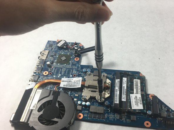

  12. HP Pavilion g4-1117dx Fan Replacement, Fan: crwdns2935265:013crwdnd2935265:01crwdnd2935265:02crwdne2935265:0 HP Pavilion g4-1117dx Fan Replacement, Fan: crwdns2935265:013crwdnd2935265:02crwdnd2935265:02crwdne2935265:0
    • Unscrew the four screws JIS #0 screws on the back side of the motherboard.
    • Screws will loosen but do not come completely out.
    • The screws are the only thing keeping the fan attached to the motherboard.
