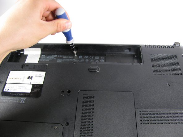

  3. HP Pavilion dv9000 Keyboard Replacement, Keyboard: crwdns2935265:03crwdnd2935265:01crwdnd2935265:02crwdne2935265:0 HP Pavilion dv9000 Keyboard Replacement, Keyboard: crwdns2935265:03crwdnd2935265:02crwdnd2935265:02crwdne2935265:0
    • Remove the six 5 mm screws in the battery compartment using Phillips #1 screwdriver.
    • Remove the 7mm keyboard screw located towards the center of the laptop with a Phillips #1 screwdriver.

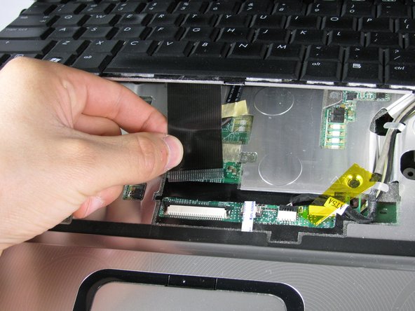

  6. HP Pavilion dv9000 Keyboard Replacement: crwdns2935265:06crwdnd2935265:01crwdnd2935265:03crwdne2935265:0 HP Pavilion dv9000 Keyboard Replacement: crwdns2935265:06crwdnd2935265:02crwdnd2935265:03crwdne2935265:0 HP Pavilion dv9000 Keyboard Replacement: crwdns2935265:06crwdnd2935265:03crwdnd2935265:03crwdne2935265:0
    • Using a Phillips #1 screwdriver, remove the three 5mm screws holding the keyboard in place.
    • Carefully lift the keyboard up (no more than a few cm) and slide it forward, towards the laptops monitor to reveal another larger ribbon cable.
    • Be extremely careful as the keyboard is still attached to the computer by the larger ribbon cable.

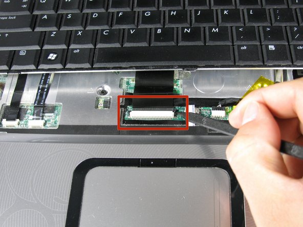

  7. HP Pavilion dv9000 Keyboard Replacement: crwdns2935265:07crwdnd2935265:01crwdnd2935265:03crwdne2935265:0 HP Pavilion dv9000 Keyboard Replacement: crwdns2935265:07crwdnd2935265:02crwdnd2935265:03crwdne2935265:0 HP Pavilion dv9000 Keyboard Replacement: crwdns2935265:07crwdnd2935265:03crwdnd2935265:03crwdne2935265:0
    • Use a spudger to push the black tab forward and slide it away from the white connector.
    • Gently pull the ribbon cable from the connector housing.
    • Remove the keyboard.
